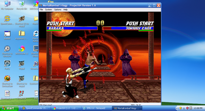

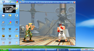

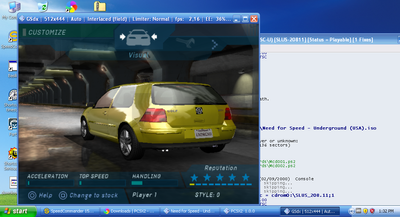

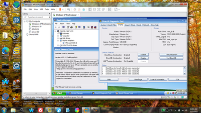

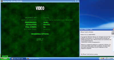

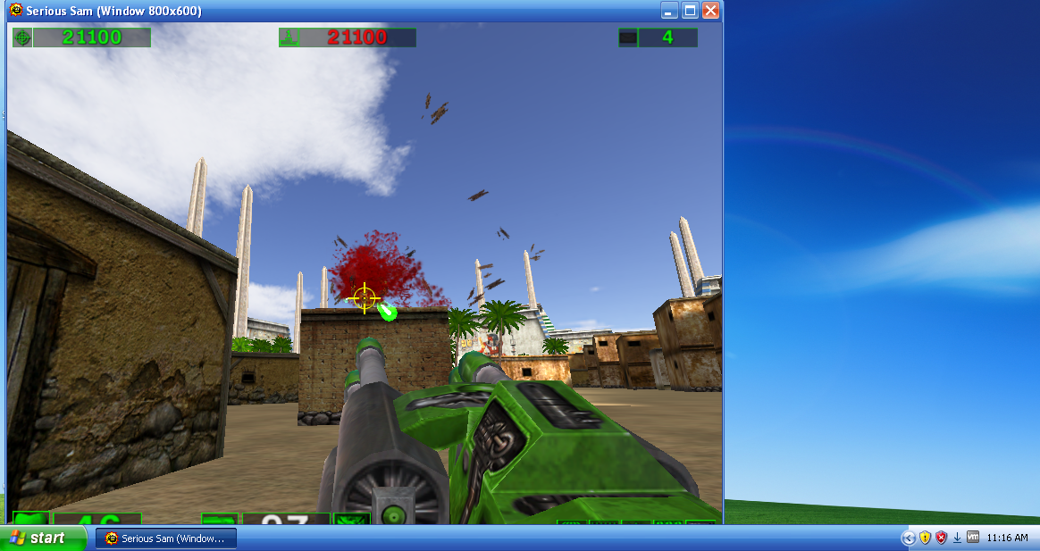

Reply 16 of 24, by Norton Commander
kamiledi15 wrote on 2024-10-25, 13:08:
I installed VM Tools immediately, so I have them. I suppose thatm VM Tools and guest additions is the same?
About virtualization tech, I don't know whether my CPU supports it - I have AMD Ryzen 7 7700.
Your CPU supports it but it's probably disabled in your BIOS (I had to enable on mine to get 3D acceleration in VMWare Workstation/Windows XP).
https://www.goodtechmaster.com/how-to-enable- … zen-processors/
The attachment XP VMWare.png is no longer available
The attachment Windows XP Professional-2023-05-08-13-32-33.png is no longer available
The attachment Windows XP Professional-2023-05-02-11-50-12.png is no longer available
The attachment Windows XP Professional-2023-05-02-12-08-10.png is no longer available
The attachment Windows XP Professional-2024-10-25-11-15-28.png is no longer available
These games/emulators all run smoothly in full screen but I have them set to windowed so you can see it's running in XP with VMWare.
https://www.youtube.com/watch?v=koQo19tpvZs
