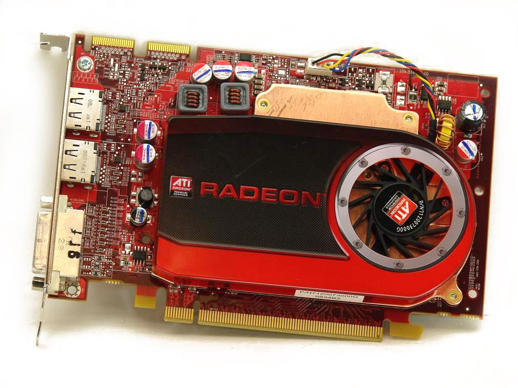

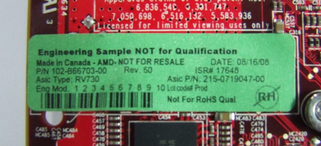

Apparently, not having made it in time for the release, AMD sent out the FirePro V5700 for review in the HD4670 version with the corresponding BIOS.
https://www.neoseeker.com/Articles/Hardware/R … s/hd4670/2.html
https://www.vmodtech.com/main/article/amd-ati-hd-4670/all/1/
This very BIOS is wanted, suddenly someone came across this very card.
I want to try to flash FirePro to Radeon HD

Reply 1 of 2, by shevalier
https://www.alibaba.com/product-detail/Used-f … 1291968798.html
http://yjfy.com/Museum/video/HD4670_ES.htm
Damn, but no one publishes BIOS. 🙁

It turned out to be so easy that it wasn't even sporty.
Why convert FirePro B5700 to HD4670
- Higher standard frequencies
- AMD Overdrive tab available (for manual overclocking)
- Drivers available for more operating systems.
Download
- Radeon BIOS Editor
https://www.techpowerup.com/download/techpowe … on-bios-editor/
- GPU-Z
https://www.techpowerup.com/download/techpowerup-gpu-z/
- Ati winflash
https://www.techpowerup.com/download/ati-winflash/
1. Save the video BIOS using GPU-Z (the arrow next to ‘BIOS Version’ in the same line).
2. Open the saved BIOS using the RBE. ("unable to find overdrive setting" - OK)
3. Remember ‘vendor’
In my case, it is 0x1002 - ATI.
4. Replace the "video card" from FireGL V5700 to HD4670.
5. Save the bios
6. Download any BIOS for 4670 from the same manufacturer.
For ATI, I used this one.
https://www.techpowerup.com/vgabios/50300/50300
Open it with RBE, go to the “Additional Features” tab, and save the HASH for overdrive.
“Method 1 - Save”
Close RBE and forget about this BIOS, it is only a HASH donor.
7. Open BIOS from step 5 (you now also have a Fan Settings tab).
Additional Features tab - Method 1 - Load.
Select the saved HASH file.
8. Save BIOS.
That's it.
No adventures with softstrap bits like with nVidia VideoBIOS.
Just change the device ID
Force reprogramming using ATI winflash utility directly from Windows.
amdvbflash.exe -unlockrom 0
amdvbflash.exe -f -p 0 mb.rom
amdvbflash.exe -v 0 mb.rom
Then you can also adjust the frequencies, select the GPU voltages, and configure the fan in the same RBE.
