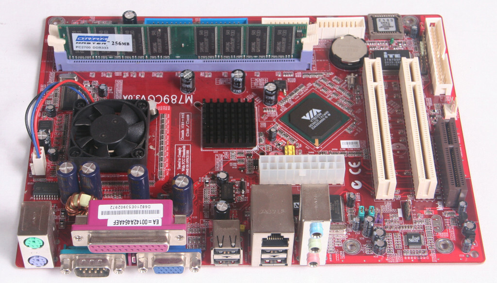

does my HP 2133 with c7 @ 1.2Ghz counts?
All the c3 i ever seen came in a Pcchips 789CG and similars paired with the shittiest parts on the market at that time. Then that place was occupied with Durons Spitfire and morgan SOLDERED to similar Pcchips
i really, REALLY hated when i visited a client and had one of those, it was guaranted a waste of time. So of course, when they started to come as a trade in for upgrades, it was going all straight to recycle.
