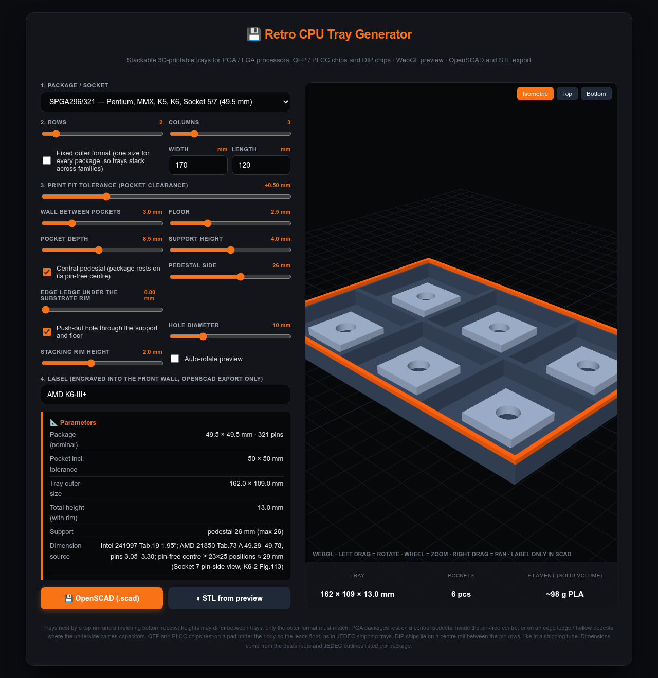

Chip Tray Generator — a small browser tool that generates stackable, 3D-printable storage trays for retro chips.
Use it online · source on GitHub (single HTML file, MIT)
What it does
  • Three package families: PGA/LGA CPUs (PGA68/132/168, Socket 5/7, 370, A, 423, 478, 604, 754/939, AM2/AM3, LGA 775), QFP/PLCC chips (TQFP-100 to PQFP-240, PLCC-20 to PLCC-84) and DIP chips (DIP-8 to DIP-64, chips end to end in channels).
  • Pick a package, rows × columns, wall thickness, pocket depth and print tolerance; live 3D preview; export OpenSCAD (exact, parametric, engraved label) or STL straight from the preview.
  • Stacking: a rim on top and a matching recess underneath, so trays nest. With "fixed outer format" every tray gets the same footprint regardless of package, so a 386 tray stacks on a Socket 7 tray on a DIP-40 tray. Tray heights may differ.
  • The chip never rests on its pins or leads: ceramic PGAs sit on a pedestal inside the pin-free centre (with a push-out hole), FC-PGA 370 and the newer sockets on an edge ledge because Intel/AMD put capacitors on the underside, QFP/PLCC on a pad under the body, DIPs on a centre rail between the pin rows like in a shipping tube. The tool warns when a support would touch pins, capacitors or lead feet.

Big update — package dimensions corrected, please re-export
Start with the important one. PGA132 (386DX) was wrong — I had 34.5 mm, the drawing says 1.450 in = 36.802 mm (Intel 231630, Fig. 8.1). Thanks Boohyaka for catching it. A 386 printed from the old version has a pocket over 2 mm too small, which is the difference between a chip dropping in and not going in at all.
So I went back over every PGA against its actual drawing instead of trusting my notes, and took the largest published dimension in each case so any vendor's specimen fits:
  • PGA68 (287 / 387) 27.9 → 29.5
  • PGA132 (386DX) 34.5 → 36.8
  • PGA168/169 (486, Socket 1–3) 44.5 → 45.2
  • Socket 5 / 7 / 370 / A 49.5 → 49.8
Every package now shows the source it came from in the parameter table, so you can check my work rather than take my word for it. If you printed PGA trays from an earlier version, re-export them.
The rest of what is new:
  • Push-out hole on every package. It used to be tied to the centre pedestal, so everything that rests on an edge ledge (Socket 423/478/604/754/939/AM2, LGA775) had no hole at all. Spotted by Dothan Burger. DIP channels get one hole per chip position through the rail.
  • Finger notches — the walls between pockets are slotted down to the level the chip rests on, on both axes, so you can pinch a chip out from the side instead of only pushing it up through the hole
  • The nesting step under the outer edge is now a choice: a 45° chamfer that prints without support, or the plain square step if you would rather add support in the slicer. Both nest the same — the chamfer sits above the part that goes inside the rim, so it never touches it.
  • 3MF export, alongside STL and OpenSCAD. The raised label comes out as a separate part with its own material, so a dual-colour printer can put it on the second extruder, and it loads as one object with two parts rather than several objects at different heights. The preview shows the label in that material's colour.
  • Label on the front wall, raised (real geometry, exported) or engraved (cut by the OpenSCAD export). Case is kept as you type it.
  • Warnings when something will not work: outer wall too thin for the nesting recess, pockets that do not fit a fixed format, DIP channels longer than the tray
  • The page uses the whole window now — the controls scroll on their own and the 3D preview takes the rest, instead of being squeezed into half the width
Verified on a real print so far: PGA168 (486), 5×3, on a Bambu Lab — thanks Boohyaka.
Still unverified by anyone: two trays actually nesting. I have no printer here, so that part is only proven in CAD (I check it by intersecting two stacked trays in OpenSCAD and confirming the overlap is zero). If somebody prints a pair, I would like to hear whether the 0.5 mm default tolerance is right, or whether it wants to be tighter or looser.
