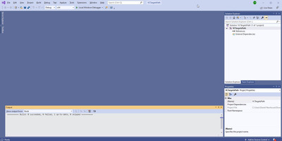

You need to make Qsynth before you can install it. Thank heavens for WinRAR - it works better with any tar (tape archive). I got a little ways with CMake and reading readme.CMake. The build directory is superfluous. I got a build done with the "release" rather than the "debug" stipulation, and a Visual C++ project is built. I tried build and I get this - nothing.
