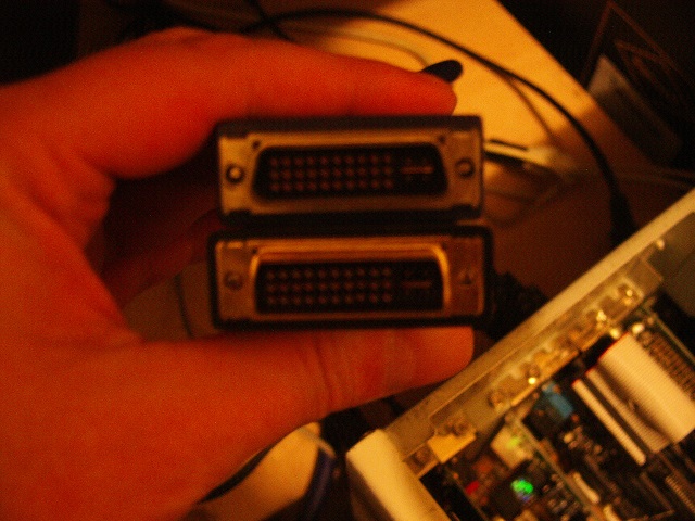

Be careful buying a P&D adapter though... I've wasted money on 2 so far. I have no idea if they would work or not, they don't fit 🙁 The pins line up perfectly, but the shell doesn't fit around the port (too small.) Still debating if I should risk clipping part of the shell off or not. The second one I purchased "looked" like it would fit (in the picture,) but has the same problem. 🙁
The attachment IMAG0001.JPG is no longer available
As you can see (please excuse my poor camera,) the top connector (from the V3 Octopus,) is noticeably different than the P&D adapter I have.
Feeding Dragon
Reply 6 of 16, by FeedingDragon
Just to complete my attempts.... Considering the low cost of this adapter, I took a chance and use a pair of stout needle nose to stretch out the outer fitting (can't think of what it's called,) so that it would fit over the connector on the Voodoo 3 3500 connector.. It works just fine, and the video is actually sharper than with the octopus attached. Since I don't plan to use all those extra features on the octopus, I can just stick with the adapter for now 😀 It is a M1-A(P&D) to VGA adapter... M1-A(P&D) Male to VGA (HD-15) Female Adapter. A bit of searching may find one that actually fits correctly, but after 2 attempts, I just stuck with this one, carefully modified.

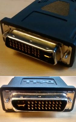

Reply 8 of 16, by lazibayer
I got 3 converters and tested them out today. The best one came from DELL, as it is a direct fit to Voodoo3 TV, except the unit I got has a recessed corner.
The attachment DELLpnd.png is no longer available
Everything works beautifully after I pulled that corner out.

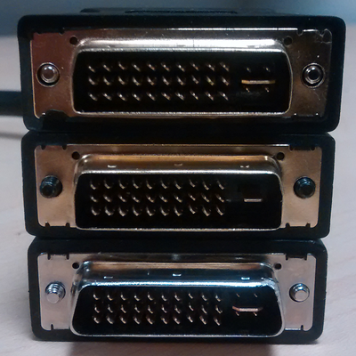

The other two converters need some more work to make them fit:
The attachment pndconverters.png is no longer available
One of them is VGA and the other is DVI. No the DVI one doesn't work.
