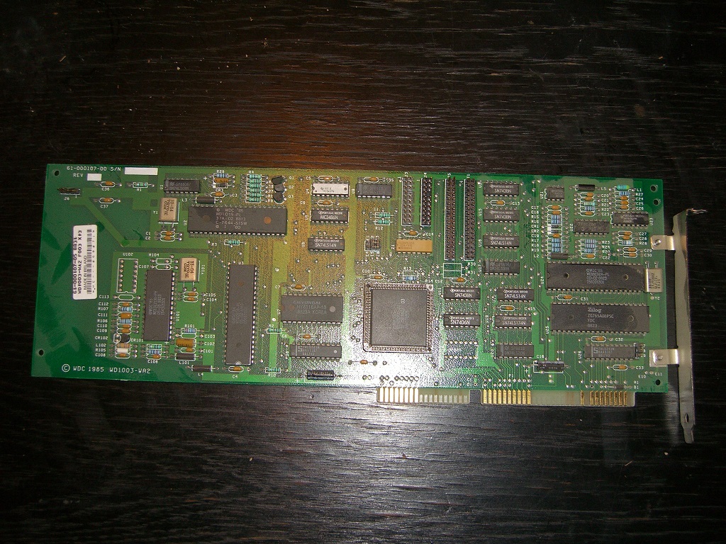

The HDD and floppy controller card.

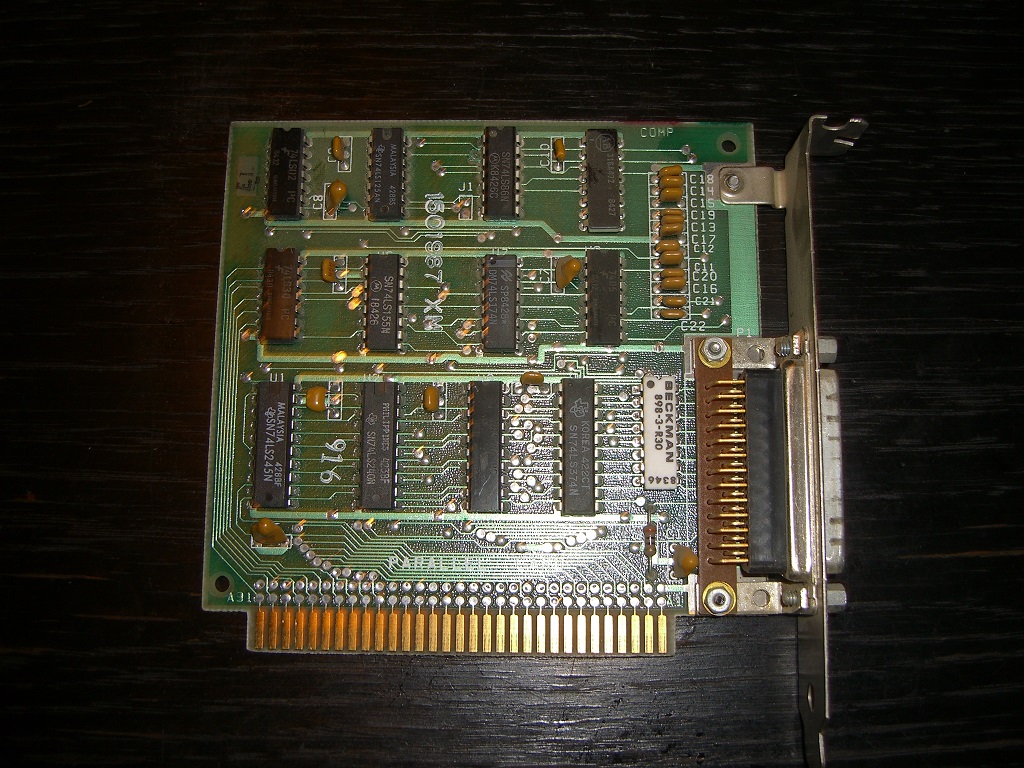

The Parallel port card.

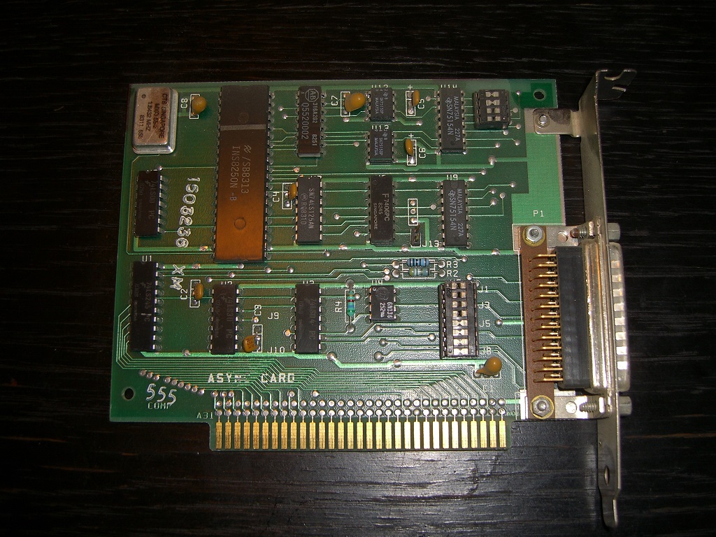

The Serial port card.

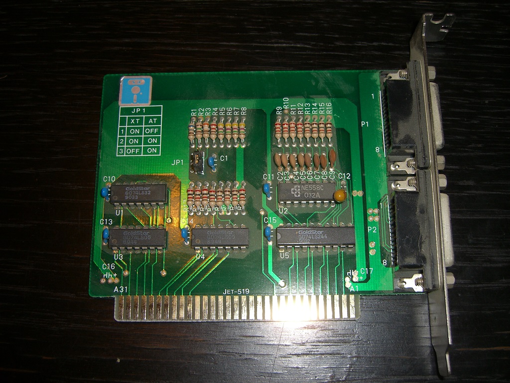

The Game port card.

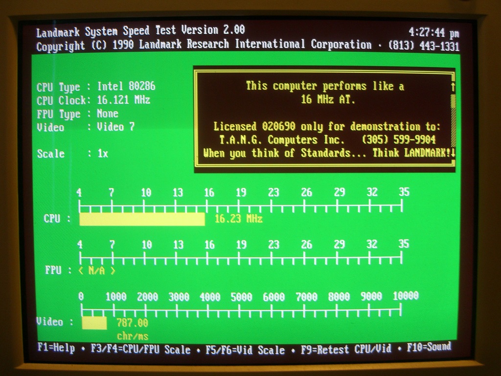

Landmark: The system scores like a 286 16 MHz 😀

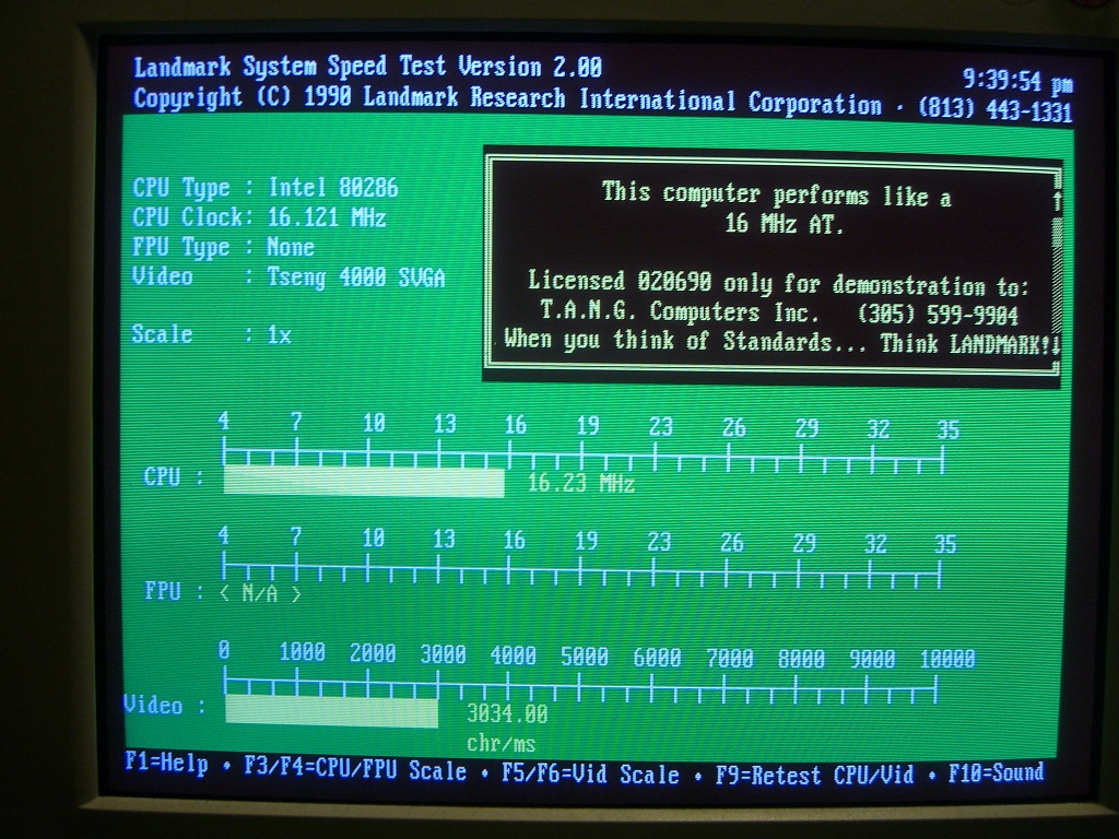

Landmark: With the Tseng 4000 1MB, now the video performance is good enough for some more games.

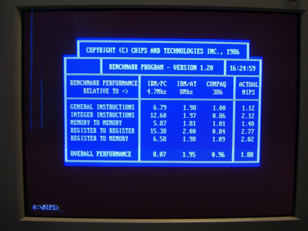

MIPS: The system is almost as fast as a Compaq 386 (I would guess a 386 SX 16 MHz).

The Video Seven Vega card uses Cirrus Logic CL-GD420 and CL-GD410.
The card supports VGA, EGA and CGA and has both a normal 15 pin analog connector and a 9 pin EGA connector.
You set the card to VGA, EGA or CGA mode with dip switches.
The card is very slow though and I felt like playing Stunts so I installed a Tseng 4000 card in the system.

The ET4000 is the only 16 bit ISA (S)VGA card I own, just as you guessed.
Stunts ran fine in "MCGA" mode with all graphics options enabled 😀

Love the Floppy logo on the Game card. Whats with the 2 Game ports though? Can it support 2 joysticks?

Its possible to connect two joysticks.
I think everything in the system is original except for the game port card and the 3.5" floppy. The computer was probably retired from its original purpose late 1994. Someone took it home and installed DOS 6.2, the game port card and the 3.5" floppy only to never used the system again. At least there were no traces of any use later than late 1994 on the HDD.
As you can see in the picture there were missing screws and disconnected cables so I think the last thing the last user of this computer did was tinkering and moving the cards around. The person I got the system from never used it or even knew what it was. I figure the system has been in someones garage since the 90s then trashed during a clean out. The person I bought the system from probably has access to a recycling center or something like that.
