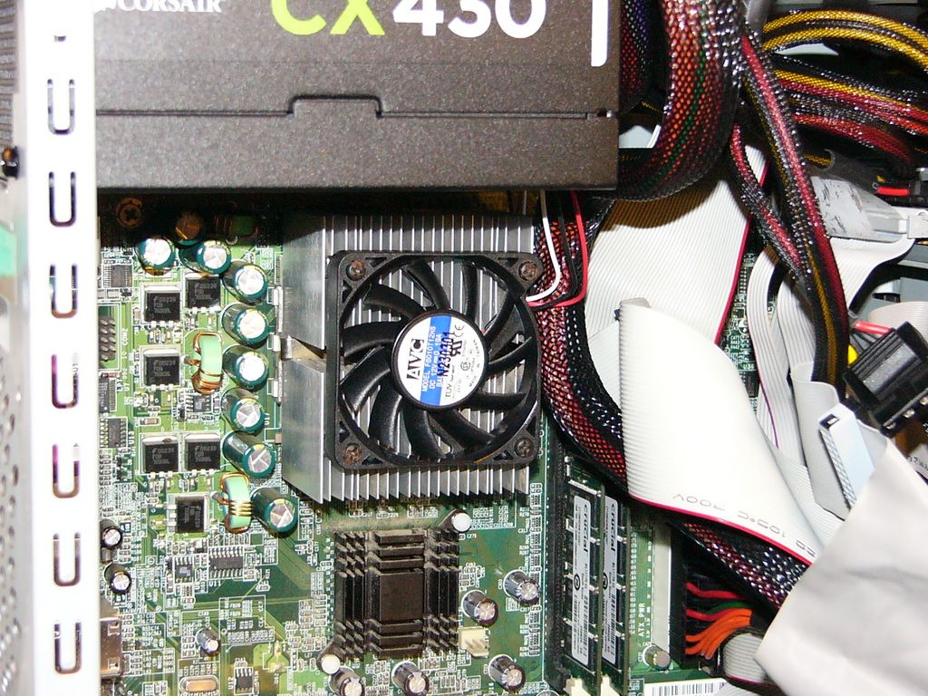

I rescued an e-Machines T2460 and have decided to make it my main XP build. It has an Athlon XP 2400+.
It was pretty noisy, so I replaced the stock PS with a Corsair CX430 I had. Turns out that the noise is from the 60mm fan on the CPU heatsink. I replaced it with the new one that's shown in the photo below, but the noise level is the same.
Are there any brands of quiet 60mm heatsink fans? Or are they all going to be this noisy unless I replace the heatsink/cooling solution? Thanks in advance for any advice.
Reply 1 of 18, by swaaye
Wire it up to 5v or 7v. 7v is made using the difference of 12v and 5v (search for details). Instant quieter fan. The reduced airflow could lead to overheating though so watch that.
Reply 3 of 18, by Matth79
There might be room to use an 80mm to 60mm fan adapter, and the separation would eliminate "blade chop" noise from the blades passing over the fins
Reply 4 of 18, by boxpressed
I appreciate all of the suggestions. I'm not very adept at mods, so I took keropi's advice and ordered one of the Scythe fans. I'll report back when it arrives Wednesday.
Reply 5 of 18, by raymangold
That e-machines mobo has some TEAPO capacitors and what looks to be like G-Luxon or something.
Amazingly the VRM caps are sanyo.
Because the low quality capacitors are in lesser critical areas, it'll probably work for awhile (assuming the sanyos are not fakes).

Reply 8 of 18, by candle_86
biggest problem is the turbulance of air over the fins, you only really need to life the fan about 1/8in from the fins and you likely wont notice it
Reply 9 of 18, by ODwilly
The cheap Chinese 3 pin 60mm fans from ebay seem to be fairly silent. I have two of them and so far am impressed with the airflow and noise level both.
Reply 10 of 18, by jwt27
Just tie a 120/140mm fan to it with tie wraps or something. This will provide some air flow to the VRM coils and transistors too 😉
For absolute silence, I can recommend the Scythe 120mm 800rpm or Antec TrueQuiet 140mm.
Reply 11 of 18, by obobskivich
If I remember right, there is a 60mm variant of the Vantec Stealth, which should be a good alternative as well. Replacing/upgrading the heatsink wouldn't be a bad idea either, if you can find something nice at a reasonable price.

Reply 14 of 18, by boxpressed
The Scythe fan arrived early, and I just installed it. Very quiet! I would say the fan noise is cut in half, if not more. A perfect solution to the problem. Thanks again, keropi!
