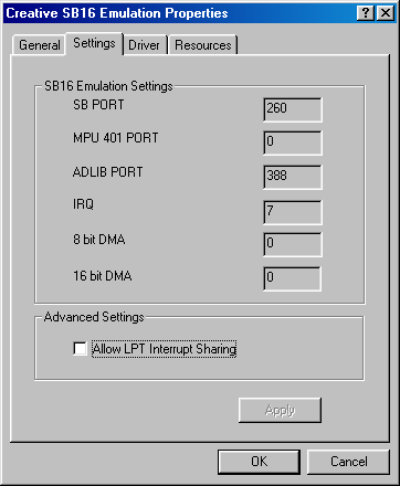

Reply 16 of 22, by alexanrs
You mean OPL? The VxD drivers have OPL emulation, but it sucks. If you need a PCI card for OPL emulation you'll have to go with Yamaha's YMF-724 chip.
If you mean digital sound, the VxD drivers offer SB16 compatibility. The WDM drivers offer the Windows' built in SBPro compatibility.
If you mean MPU-401 UART, yeah it does.
Reply 17 of 22, by Stretch
Here is a screenshot from the device manager. I will try tomorrow to see how it sounds.
