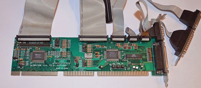

Reply 16 of 22, by chrisNova777
this is the io controller i have.. perhaps the serial ports are damaged somehow.
    314.67 KiB
    1077 views
Reply 17 of 22, by psychz
Have you checked its jumper settings? (W36-W41)
Stojke wrote:
Reply 19 of 22, by tayyare
Default for COM1 and COM2:
COM1: I/O port 3F8, IRQ 4
COM2: I/O port 2F8, IRQ 3
