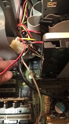

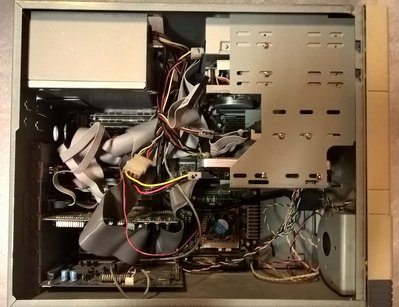

I picked up a Socket 7 system at someone's place, and I plan on using it for word processing. I have run into problems with it, and I am out of ideas as to how to resolve these.
A first thing I should mention is that the guy I bought it from (understandably) took out the hard drive, so I have never actually seen this machine work under a real operating system. When I first started up the PC after I got it home I could, however, enter the BIOS (it said that the RTC battery was empty). I looked for details regarding the motherboard there, but I could not find any.
I turned the PC off, put in a hard drive (less than 6GB in size) I had lying around, and connected it to the board with the 40-wire IDE cable that was inside the case. I took care to connect the longest side of the cable onto the motherboard. I do not know whether all 40-wire cables are like the one in this system, but the connectors on this cable are shaped in such a way that you can plug them onto a motherboard or a hard drive "both" ways (I mean, you can turn the connector 180 degrees and it will still plug just fine onto either the motherboard or the hard drive). The strange thing was that with the hard drive connected to the motherboard, the PC would not boot. There was no BIOS screen, no beeps, no lights going on on the keyboard. The screen was black.
I turned the PC off again, disconnected the drive, turned on the PC once more, and there was the BIOS screen again.
I thought it would be a good idea to first replace the CMOS battery (it is empty, as I said). That was when I discovered that in very old systems like this one the CMOS memory was powered by another type of battery, called RTC battery (a little black rectangular box on the motherboard, see the third photo). I found the RTC battery on the board, and pried it off (it said 'benchmarq' on it and it was inside a socket --instead of being soldered onto the board). I reseated the RTC battery into its socket, hooked up the system to the power outlet, pressed the power button, and this time there was only a black screen. The hard drive was not connected to the motherboard at that time. And, yes, the graphics card was connected to the display. I pried the CMOS battery out off its socket once more, and left it out while I powered the system on again. Still, only a black screen.
I then read that on old systems like this one removing the CMOS battery is not enough to reset the BIOS. If what I read and remember is correct you also need to set certain jumper settings so that when you power on the system (without the CMOS battery) the BIOS will be reset. Then you power off the system again, reseat the RTC battery (or place a new one), and you can use the system with its BIOS reset. the thing here is that I am not sure of the brand and model of the motherboard. I wrote down some numbers that I found on the motherboard, and from what I found on the internet I suspect the board is an Intel 430FX, but I am not sure. The brand and model of the system as a whole are a complete mystery to me.

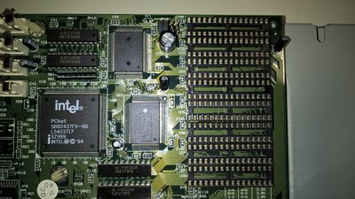

These numbers --all of which I found on black chips on the motherboard-- are the following.
PCIset
S82438FX
PCIset
SB82437FX-66 (see fourth photo)
PCIset
SB82371FB

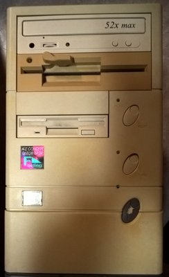

    932.13 KiB
    918 views
    847.14 KiB
    918 views

I would start by taking it all apart, and do a test-bench setup. From that point, you can work you'r way through to a working machine.
When all hardware and software are working, then put it all back in the case.
This aproach will let you work out all the quirks, more easy and you will get to know the system in and out.
Take some photo's of the motherboard, and all other parts and post them here on Vogons.

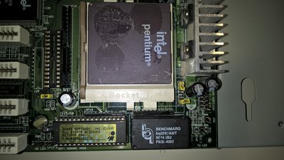

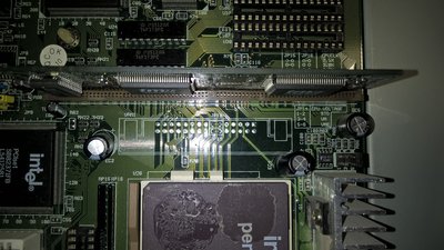

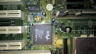

What do you think of these photos?
I took these with my mobile phone. I do have a good digital camera around, but the batteries are dead at the moment. If you need a better photo, I can take one tomorrow.

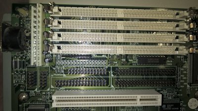

Reply 14 of 39, by Malvineous

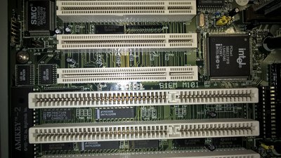

What does the writing say between the PCI and ISA slot? It looks like it ends in M101. There's a good chance that'll be the motherboard model.

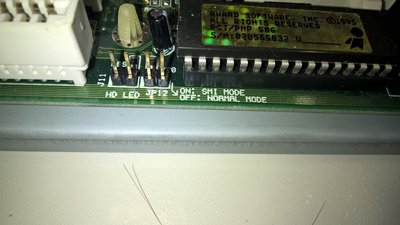

Also what does the writing say below the Award Software BIOS chip? I can see "OFF: Normal mode" but I can't make out what it says should happen in the ON position.
Reply 16 of 39, by Malvineous
That looks like it! I guess that means the obscured writing is 5IEM M101. And the writing below the jumper is apparently for the green PC switch, so the hidden writing probably says something like "ON: Sleep mode" or similar.

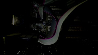

Thanks so far guys!
Apparently, my digital camera is not as good as I thought.
I made new pictures with my mobile phone, but this time every photo is just one segment of the motherboard.
Indeed.
It says "On: SMI Mode".
    2.9 MiB
    666 views
    ISA slots
    3.05 MiB
    666 views
    Detail of the writing between the ISA and PCI slots
    3.87 MiB
    666 views
    PCI slots
    2.99 MiB
    666 views
    RAM slots

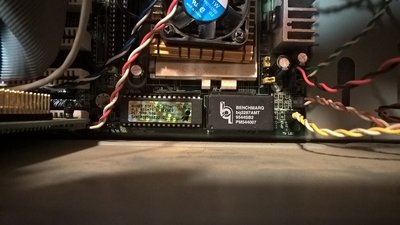

Reply 18 of 39, by Odiseo

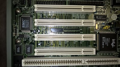

Here is the rest of the pictures.
    2.7 MiB
    666 views
    3.99 MiB
    666 views
    2.88 MiB
    666 views
    3.47 MiB
    666 views
