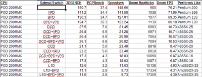

So in the process of trying to gather results from 486 and faster systems with caches disabled, I've been playing a lot with gerwin's Setmul utility.
What a neat tool! I finally took the time to dive a little deeper in the documentation (just reading setmul /? gives a world of info) and realized that there are a ton of switches available to Pentium owners. So I decided to try to test every combination of switches I could with my Pentium Overdrive 200. 😉
36.93 KiB
4489 views
Even on a Pentium, there is way more to this utility than just disabling L1 cache. I was able to get down almost to an Am386SX40; I equaled an Am386DX40; and I got close to an i486SX25.
Not to mention all the other features for owners of many other types of processors. Thank you, gerwin!

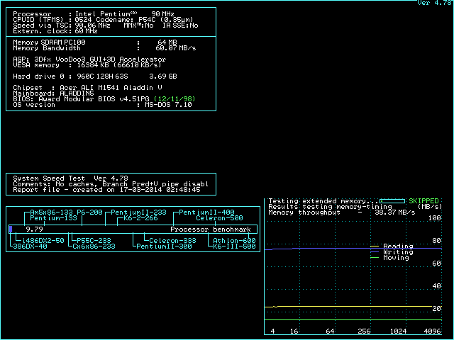

Nice to see these Pentium options of SetMul put to good use!
Originally I tested it on a Gold-Capped Pentium 90MHz (P54C): All worked fine. After that I also tried it with one of my Pentium MMX processors, 200 or 233MHz (P55C): The TR12 switches no longer had any effect, as if intel removed these registers... So I am surprised to see it work on the POD 200. POD 200 being an MMX model AFAIK.
Edit: correction - The TR12 settings actually do slow down all six different Pentium MMX processors I have here. i just tested that properly. So AFAIK it just works with any Socket 7 Pentium.

Your P90 is a bit faster than mine (8.97) with L1D. If not too much trouble, would you mind adding your results to my compilation?

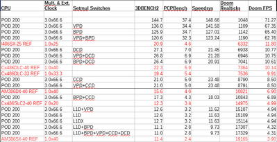

Here are all the combinations of setmul switches and how they effect performance on my POD 200MMX:

Sadly, in retesting my Pentium 120 cpu with the test registers, I found DCD and CCD (data and code cache) have no effect. These two switches are what allow my POD 200MMX to get into 486 levels of performance. VPD and BPD do work, which allow smaller performance drops into P90 and P100 ranges, and disabling L1 gets me down to Am386SX-40. I'm pretty stoked that the POD supports all these TRs, it makes it a very flexible CPU, from 386DX-25->386DX-33->486-16->486-20->486-25->P120->P133->P166->P200.
