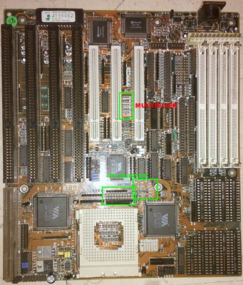

Googled a bit on VIA Pluto but didn't find this one. It has "T.W." printed just above the VLB slot; I've seen this before on a 386 board, don't know what it is... Looks like a great candidate for an Am486DX4 build, however I'm totally in the dark about its settings. Any kind of help would be appreciated!

Reply 7 of 22, by brassicGamer
Well, following a visual search on Google and browsing of every single 486 board on TH99, your board is not coming up. Without a manufacturer or model number it will be impossible to identify the board unless someone recognises it.
Do you have a 5v CPU you can drop in to get the BIOS string? Worst case scenario in that instance would be that it doesn't POST and you experiment with jumpers until it does.

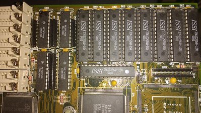

I would use a more common processor on that motherboard, like a DX 2 66 or a DX 4 100.
Do you also have the cache chips for that board.?
Reply 13 of 22, by psychz
Oh! I see 😜
@Robin4: No, but I guess I can pull said chips off one of my other 486 boards + a tag chip?

Reply 14 of 22, by Brickpad
Have a look at the areas I have highlighted for you. This should help you configure the board for the appropriate processor you want to install. Right now it appears to be configured to run an AMD processor (JRN5).

Reply 15 of 22, by psychz
Yup, already noticed these, also I assume that the JT1-7 jumpers on the bottom left of the picture (just between the VLB slot and the regulator) are for CPU voltage selection (no pcb printed info on these), and don't know anything about the jumpers on the left of the chip just above the CPU type selector... Maybe I can find more answers after actually getting it to POST!
