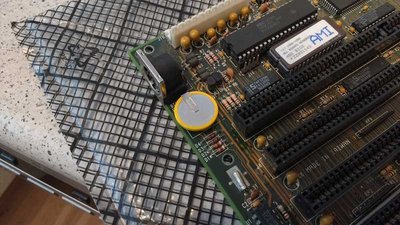

First post, by einr
Because I might have. Am I going to damage anything?
There are no polarity markings on the 4-pin external battery header of my 486 motherboard so I guessed.
The system works fine but did not remember its settings overnight. Trying to figure out if it's because the battery header is the wrong way around or because a 3V CR2032 is not enough voltage (original battery is a 3.6V lithium barrel)

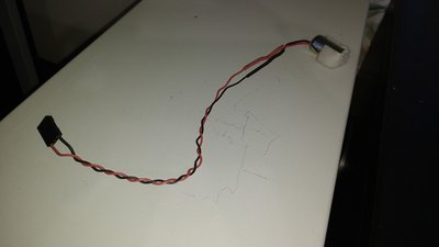

If you find this usefull, then this is how I have replaced both internal and external batteries on two of my systems.
Both batteries were 3.6volt ones. I have added both a picture of the two batteries and an eBay link for you.
The internal battery was replaced on a 486 motherboard. Actually. I soldered in a battery as the board arrived without.
The original internal battery, was however one of those barrel type ones. The battery is not heating up, and it is
still working without any issues, after some 60+ hours of computing.
The external battery was a replacement that I did. I used the original cables and soldered it to the one on the new
battery that arrived with wires allready soldered on.
Internal battery on eBay:
http://www.ebay.com/itm/New-LIR2032-Li-ion-3- … 4MAAOSwpDdVGVUE
External battery on eBay:
http://www.ebay.com/itm/New-Tekcell-SB-AA02-L … LIAAOSwgk1XF0gE

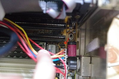

Reply 10 of 13, by einr
Well, thanks to all who replied. You are all quite helpful 😀
Anyway, I flipped the connector around. The system has been off and disconnected from the mains for many hours now and it seems to remember time and settings so I'm tentatively calling this a success. 😀
To clarify, there never has been a rechargeable battery of any kind in this computer. It has a ½AA 3.6V Lithium battery soldered to the motherboard. It looks kind of like the rechargeable NiCd kind that leaks all over the motherboard but is not one. It's functionally equivalent to a lithium CR2032 except for being slightly higher voltage and vastly more annoying to replace. So I'm happy there even was a header!

The original battery was soldered to the board, and there's a header for an external battery nearby:
141.01 KiB
868 views
There is no complete manual for this board online as far as I can tell. TH99 had the header descriptions but no pinouts/polarity.
But now the computer has been left overnight since I flipped the connector and it still remembers the settings so this is looking pretty good 😀
