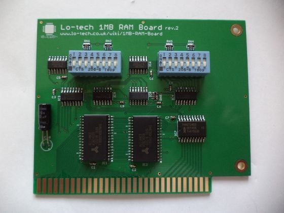

Hello, I just got done putting together a lo-tech 1Mb ram card and I also have a Sega/IBM 286 Sega Teradrive that I'm trying to figure out if I can somehow use the lo-tech 1MB card with it.

Thanks for the reply!.
How should I set the dip switches to set the 1MB card for UMBs?
Reply 3 of 22, by stamasd
According to the wiki https://www.lo-tech.co.uk/wiki/1MB-RAM-Board you set switches 2.3, 2.4, 2.5, 2.6 and 2.7 to "on"

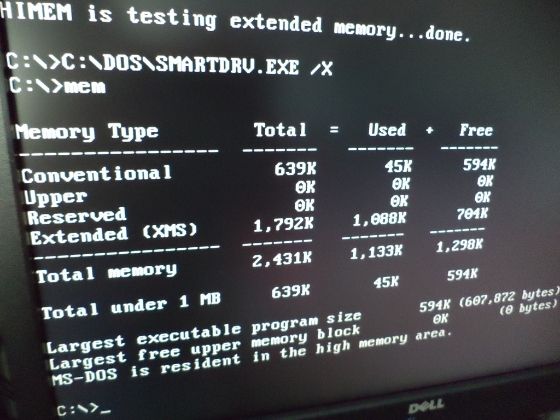

Reply 6 of 22, by Megadisk
^ As requested, after a fresh installation of MS-DOS.622 :
Also when it comes to some of the addresses, I've been told the Teradrive uses:
000h-A000h : for 640kb
A000h-C000h: VGA RAM
C000h-D000h-: some more Bios related.
D000h-E000h: EMS
E000h-FFFFh :128kb bios

Reply 11 of 22, by carlostex
If the Teradrive uses all the UMA there's no point in thinking the Lo-Tech card can give you UMB's. All the UMA are is being provided by the RAM sticks.
So the VGA chip doesn't have its own dedicated RAM? Takes 64KB from the UMA? That's laaaaame no wonder that thing is so slow...
