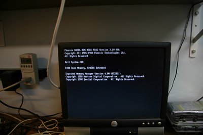

Reply 9 of 13, by lowlytech
Well I have had a chance to browse the boneyard FTP and other archived BBS type sites and I am getting discouraged if this driver exists. Looks like in the leading edge model D driver from http://ibm-pc.org/utilities/system/system.htm has an MM.SYS driver and it has the right brand which is for the Western Digital, but it shows FE2011 in the status instead of FE3021. As a side effect, the machine reboots itself in a fraction of a second after the driver loads. Was able to capture the screenshot below before the lock.

Reply 12 of 13, by lowlytech
Matth79,
That first file was it! It loads and does a memory count. I vaguely remember major.butt.care address while doing my searching and since i use chrome it would always give me a failed - network error, but IE downloaded it without issues. PM me your email and I will send you a gift. I have been trying to find this silly file for a solid 3 days..
