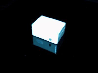

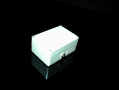

I'm no audio technican, but I think audio quality is best if both devices (card+headphones) do match in this regard.
In reality, of course, this never really is the case. What you can do is either use an external amp, turn up the volume or use a transformer.
The last one is abit special and queer, but I have done this myself for my radio hobby. 😊
I'm not sure if this does justice to hi-fidelity, but you can use a pair of audio transformers, say 1:4, 1:10 or 1:100 to correct the impedance.
I tried this several years ago to use modern headphones on a crystal radio set.
And I also tried this in reverse: I used this with my vintage crystal radio's headphones and a modern radio.
Anyway, I'm not sure what problems you have got and why the volume is so low on your card. Diagnostics like this are never easy from the far..
Perhaps it is also because the sensitivity of our heaphones are different or other electrical specs are the culprit.

    converter box, low side

    converter box, high side
