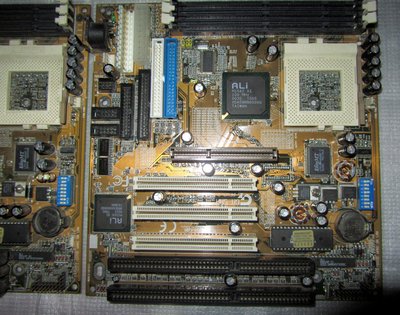

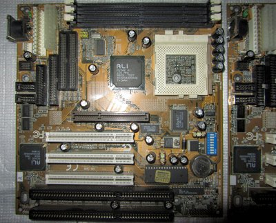

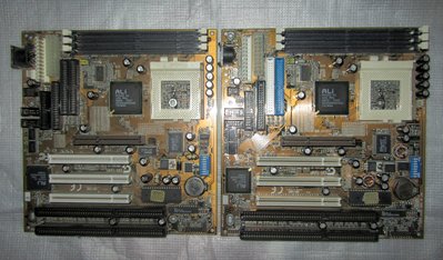

Since I have both, might as well do some documentation.
992.48 KiB
1636 views
1.22 MiB
1636 views
1.3 MiB
1636 views
Compared to the previous revision, 3.2 has the following improvements:
- Additional NEC K3296 voltage regulator (2 vs 1)
- Better VRM coils
- Additional ultra low CPU voltage options (1.3-1.9v)
- Colored IDE connectors
- South bridge M1543C revision B1 (A1 on 2.2)
- Stepping D north bridge M1542 with integrated TAG RAM (optional, 512mb RAM cached)*
- Revision C1 M5819P IC chip (B1 on 2.2)
- More streamlined jumper configuration
- Different capacitor manufacturer: Hermei (3.2) vs Choyo + GSC (2.2)**
*Looks like revision 2.2 comes only with external cache, so only 128mb RAM can be cached on those.
**Looks like most early 3.2 boards with external TAG (stepping E NB) are still Choyo + GSC combo.

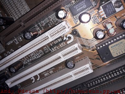

Did some further investigation and found photos of revision 1.1:
890.47 KiB
1572 views
954.01 KiB
1572 views
Apart from the different PS/2 connector placement and 2-pin CPU fan, it's practically identical to the revision 2.2. Although maybe it doesn't support AMD K6Plus.

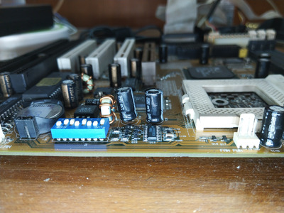

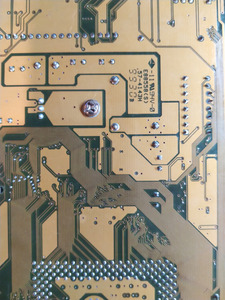

Reply 3 of 9, by kinetix
Hello my friend. Could you post a photo of the bottom of the rev2.2? if possible in detail the surroundings of the TC40 capacitor.
also, I have downloaded the motherboard manual. More specifically, two manuals, revision 2.2 and 3.2. Being the rev2.2 , this is the one I take as a guide. To test the board, instead of using the K6-2, as a "safety" measure I´m using a Pentium-166. BUT, the jumper/switch configuration in the manual and what is stamped on the board differ slightly!!
Which one do I believe?
also, In the stencil 0 (zero) is ON and X is OFF, as in the manual?
Here you go:
1.08 MiB
713 views
987.77 KiB
713 views
I had high hope of this SS7 MB, only to find at least three bulging capacitors. Unlike most bulges that crack the top with pre-carved indentations (cross, three-pronged star, or letter "K"), bulging capacitors on this MB go "downward."
1.31 MiB
713 views
The TC40 was the worst one, followed by TC45 and TC44.
Should have grabbed that Epox EP-51MVP3E-M two years ago (sigh).
kinetix wrote on 2023-09-24, 02:18:
I noticed that too. The manual gave Pentium 133-200 (w/o MMX) 3.5V but the official Vcore should be 3.3V. OTOH the manual gave Pentium-MMX the correct Vcore of 2.8V.
Yes, those were based on East Asian mindsets. 😅 Gigabyte is a Taiwanese company after all.

Reply 8 of 9, by kinetix
just want to know, be really really sure. how are the holes of C40 on the top side. can you get an even closer image , like the third image but closer, looking that pace below the capacitor.
because i was never 100% sure if one was connected to the upper big vein
Reply 9 of 9, by dormcat
kinetix wrote on 2023-11-04, 01:29:
I've already asked a skillful friend to replace those bulging caps.
