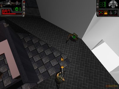

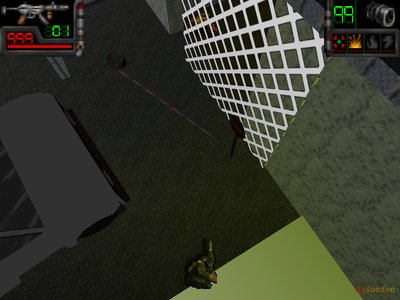

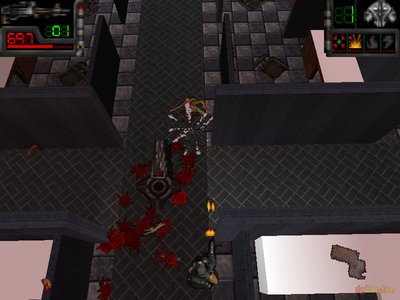

I met dgVoodoo recently and the first game I tested with it was Take No Prisoners. In game the best quality setting is D3D 16bit 800x600 but in this mode, some surfaces are without textures. For the game to be normal I need to use the 8bit 640x480 configuration (it is a great loss of visual quality).
Any configuration suggestions to apply in the dgVoodoo control panel that can fix this? I tried to change some things in the DirectX tab but they had no effect.

    Normal 640x480 8bits Fullscreen

    D3D 800x600 16bit Fullscreen

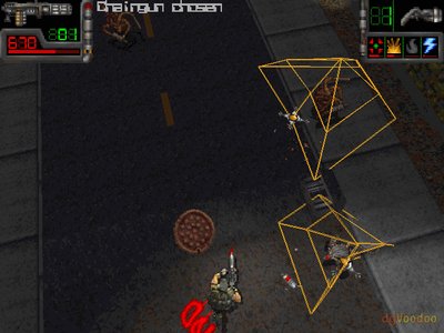

    Strange grid surrounding the enemies

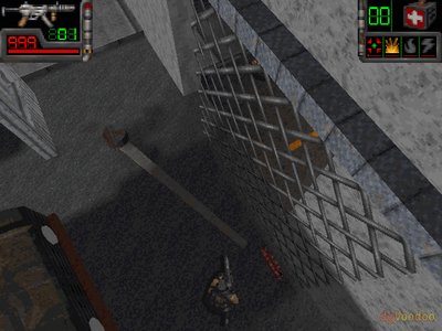

And it worked!
First I enabled the "Fast video memory access" option but it did not work. So I used version 2.54 in the default settings (and then with my personal settings) and the problems of missing textures were corrected.
What's the explanation? What is different about version 2.54 that corrected the problem?
Haaa... The "grid" around the enemies in the last image is a weapon of the game, a trap... I did not realize it and I thought it was a rendering bug.
