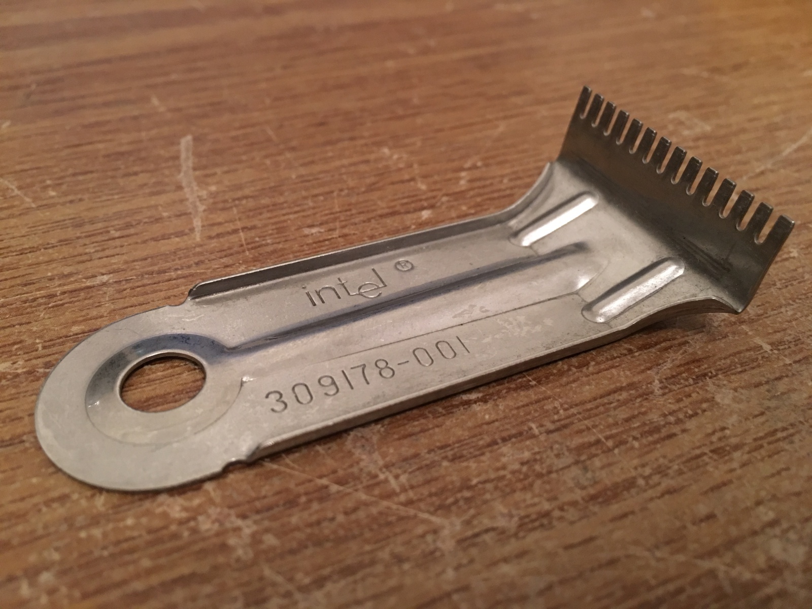

this is the tool for removing non zif socket cpus, maybye those numbers will help you track it down

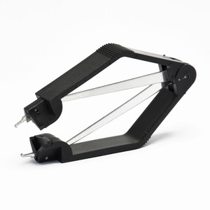

That one is intended to remove PLCC chips from their sockets. This one might make it a bit easier:

the Intel tool grips the first row of pins on socket 7, but I am curious is this a custom socket? as far as I know everything socket 3 + is a zif with a leaver

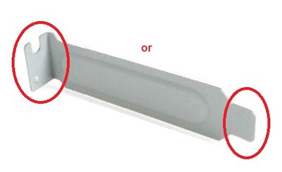

As an alternative, have you tried modding an old expansion slot cover?
21.03 KiB
343 views
You could even Dremel in a few teeth if it would make it better.
