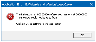

The gog Version is already patched, has all the fixes for the game and it has its own modified ddraw.dll.
Its running well on my pc: windows 10 64bit,Intel Core i5-2500k ,12GB RAM, geforce gtx 1070. But it is not using the highest refreshrate (120hz).
With dgvoodoo2 v2.61 i can force the refreshrate and enable more enhancements, i renamed the original ddraw.dll.
The game starts and i can play with no issues, until i click on a spellcategory in the spellbook.
Then it crashes with a error message:
5.91 KiB
509 views
I tried different dgvoodoo2 versions and updated my graphic card drivers. Nothing helped.
Reply 1 of 2, by Dege
I've just checked it out on both Win7 and Win10 but couldn't reproduce this.
I used a savegame from the net, selected a character and opened the spellbook but didn't crashed.
Also, could you attach the log you get with the spec release version?
