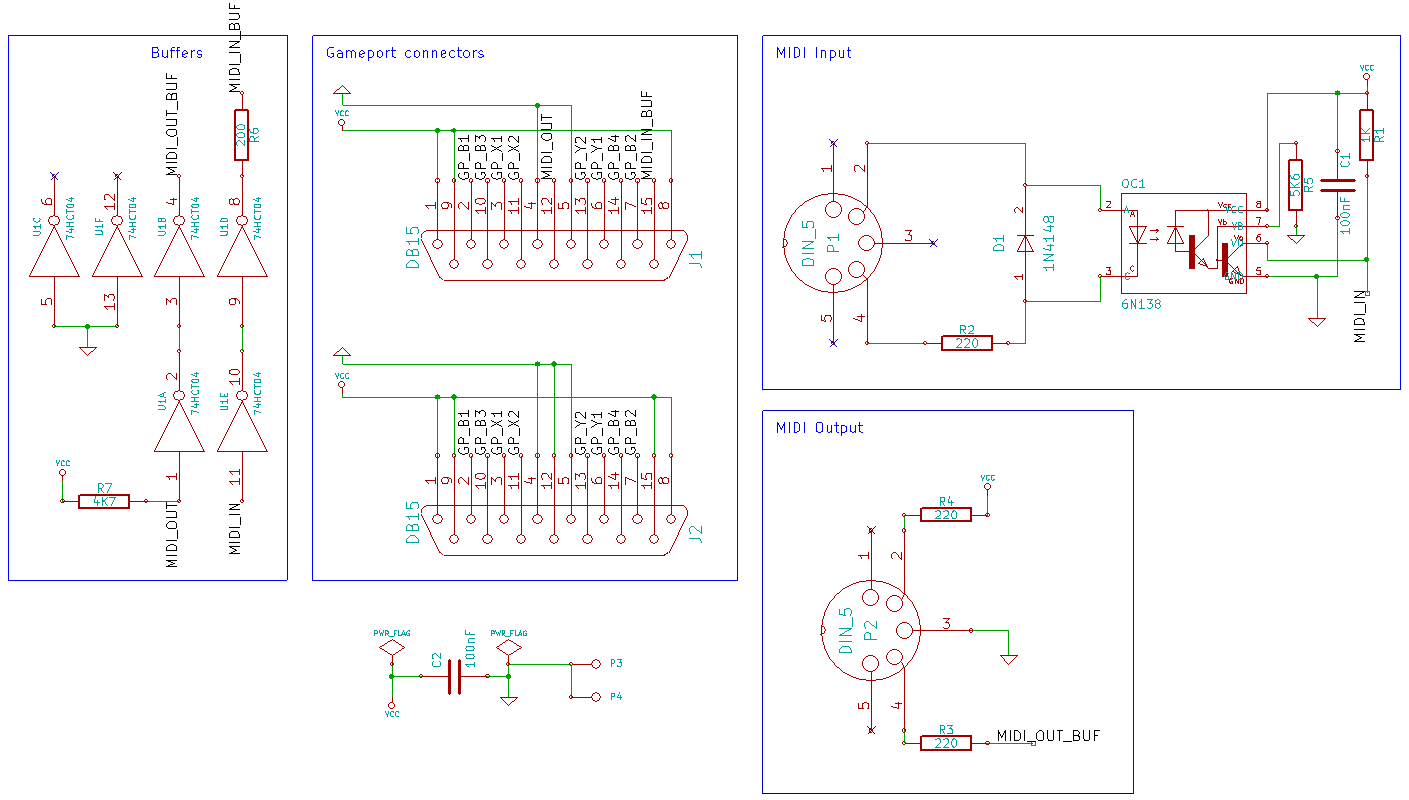

After reading about people having a bad time with cheapo cables I decided to take it apart and check out the wiring, which is why im writing this. While the soldering is acceptable, the wires are clean and even the connector shielding is grounded correctly I'm concerned its just missing the electronics required to function correctly. There are zero resistors... I'm not sure if this is normal as the impression I got from the MIDI Joystick breakout thread was there should be at least some inline resistors for the cable to do its job properly.
Anyway I'd like some second opinions before I go using a would-be duff cable and destroy some thing I care about.
Link to photos and a pin-out of the cable. https://imgur.com/a/i2kSUxB
Here is the diagram keropi posted on the aforementioned thread for reference with the resistors inline with pins 4 and 5 (pins 2&4 on my diagram).
Thanks in advance, W.

I would not use it with any gear I cared about. Get a refund. These cheap fake cables are legion on ebay.
This cannot pass through any joystick signals, so it's a pointless cost increase to even have included it.
The IC is meant to be a buffer between the MIDI device and the sound card, sort of like a fuse. In a real circuit, the MIDI OUT uses a hex inverter as a buffer, and the MIDI IN uses an optoisolator. Without these components, MIDI OUT will probably "work" but without a safety net. MIDI IN should not be used without the optoisolator.

You can't even be sure, if it will work with MIDI gear correctly at all.

So is it possible for me to buy the right components and modify this cable so it follows the correct midi specs?
I found this diagram on the thread Srandista posted, but my electronic diagram reading skills are not so good.
Small warm up project - Gameport/MIDI box schematic by user alexanrs
user keropi also posted some useful diagrams here Good schematic for simple joystick->midi-out adapter?
Any advice on creating a parts list and clear assembly instructions would be very appreciated.
Thanks W.
Edit: Here is what I have worked out so far:
1x 74HCT04 (Hex Inverter on this diagram) or possibly the more readily available 74LS00 (quad 2-input nand gate on the one in the first post) 74HCT04 allows the joystick to work simultaneously I believe.
1x 6N138 (optoisolator)
1x1N4148 (Small Signal Diode)
1x 4k7 ohm resistor
1x 200 ohm resistor
3x 220 ohm resistor
1x 5k6 ohm resistor
1x 1k ohm resistor
2x 0.1uF / 100nF Capacitor (good catch imi)

Reply 4 of 13, by imi
C1 and C2 says 100nF, those are usually all rated for high voltages anyways.
I got that same exact cable from china btw, it was pretty much the only one that was in stock and looked decent enough, I also opened it up as soon as I got it and got disappointed, at least the cables and connectors seem to be pretty decent quality... I will fix mine as well 😀

I'm setting up a 'clearer' diagram which I'll post soon, please chime in with any alterations/corrections or just anything you want to change or add. This is the first real electronics project I've done that wasn't replacing caps or following kit instructions. Cheers imi

So I tried to get a hold of alexanrs here on vogons but I've had no reply and he hasn't been on in 2 years, so I've given KiCAD a go to re-create his design to the best of my ability without just copying it.
Here's what I've managed, if anyone with PCB CAD knowledge could proof it for me that would be great.
Nothing fancy, used auto-routing and component footprints from Mouser.co.uk product listings for the components used.
I'm very new at this so It might not even be correct, I had difficulty with the pin numbering and the footprints of the components I could find available to buy online.
