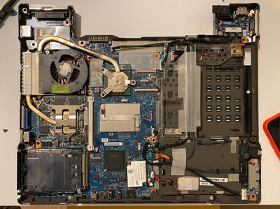

Okay, made some maintenance, re-pasted GPU and CPU, replaced almost dead HDD, cleaned of dead bugs and dust and reinstalled Windows XP.
333.7 KiB
117 views
Now I'm installing different games and testing. For now I'm really disappointed that some games are broken because GeForce 6 dropped the support to paletted textures. Yes i can fix it by applying some patches and wrappers, but that's the opposite of what i was interested in this laptop.
