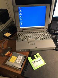

Fastforward half a year or so and I'm at work where we're throwing out these very old Supermicro Super Servers (5013C-M) which have been sitting below a storage shelf collecting dust. I quickly notice that they feature slim-type floppy drives and I decide to salvage one in the off chance that maybe, MAYBE they work!
Unfortunately the drive does not fit in its original case BUT at least the connector seems to be the same... And it WORKS! 😁

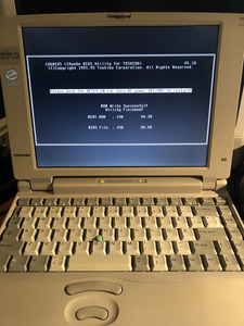

I decide to try and update the bios from version 6.30 to 6.50 using the floppy drive. This also works!

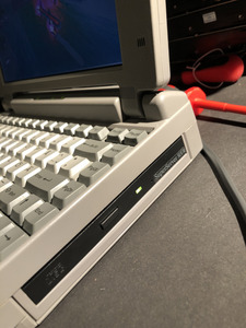

As an added bonus, the CD-Drive from the servers is also compatible with this laptop.
I left the sticker with the server name on for added coolness... 😉

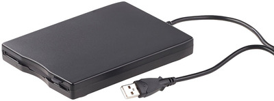

Depending on where you live regarding postage, I can hit you up with a floppy that fits.
Or, you buy yourself one of these that I usually use as substitutes for Satellites.
One of those cheap USB superslim USB Floppy drives.
They seem to be mostly TEAC old stock, and have the same formfactor and button position. They are nudered by a small PCB in the enclosure which can be removed. Afterwards they can read and write all the formats again, they have the same smaller width 26pin flat ribbon connector (with the USB translator PCB in place they work over USB, albeit only 720 and 1440 modes are available, but over the original connection they do work as originally intended).
71.97 KiB
216 views
These drives usually cost around 10-15 bucks tops.
I have successfully used these drives as substitutes in laptops of the Compaq Contura and Aero series, as well as Toshiba DynaBook, Tecra and Satellite (Pro) series.
