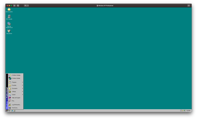

I just customized Win XP Pro to look like Win 98/2000. Looking absolutely great so far, like the real thing. The 98/2000 classic UI and the NT 5.1 under the hood. What do ya think?
Next is to get SeaMonkey 2.49.5 and skin it to look like Netscape 4.x, and why SeaMonkey? Because it's theme is almost a direct nephew of the old Netscape Communicator, and SM is a modern browser with modern capabilities. It's cheating, for sure, but having something similar to Netscape while being able to browse modern web is a great thing.
But before, anyone know how can I modify the blue bar on my start menu? The inexperience patcher did a great job, but the quality of the image there is kinda...poor. I need to make my own version. I will get the one from my Windows 2000 VM, edit to show "2002" and put it in place. I think I need to use Resource Hacker, but how and which version?

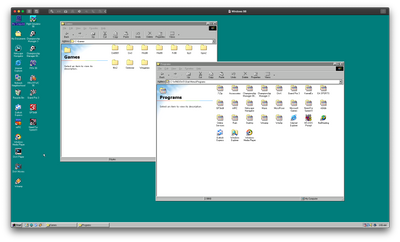

Tonight I just added a bunch of games to my Win 98 VM. All of them are running well, only FIFA 98/99 are having a problem to improve the resolution - I am locked into a 640x480 resolution. FIFA 98 can run in a higher resolution, but when I do that, the menus are all black and I have to guess where the buttons are. Once I managed to get into a friendly game, I could see the game and play in widescreen! Not the ideal, the menus need to work too. I wish I could do the same for FIFA 99. I have the same problem if I try with Win2k.
Grand Prix 3 optimal settings are 1024x768 and I cannot complain. The game is not widescreen. The positive note is I have the highest FPS possible and the lowest PO, so the game is lightning fast. I updated the game a bit with a 1998 mod so it looks better now.
CM3 and CM0001 refuse to run in windowed mode, I have to run full screen with 1024x768 too. Flight Simulator 98 is the opposite; only runs well Windowed. GPM2 I have to lower the graphics color depth every time I want to play it. NFS2 runs well too - it just CTD sometimes. (Ahhh, old Windows... how I missed that).
SimTower, my #1 favorite game, is perfectly playable. There you go, this is my Win 98 machine:
