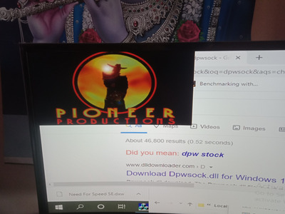

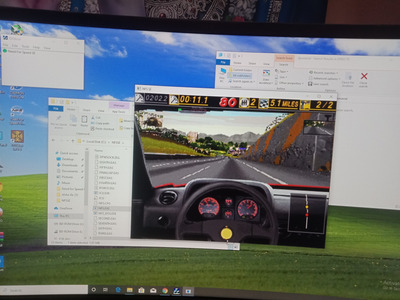

Well it worked for me on Win 10. How I achieved it:
Install NFSSE in C: directory of your main PC through DOSBox, that is files are located in C:\NFSSE
The dosbox code will be
mount c c:\
CD is mounted in the same drive as DOSBox.
My code was
mount L L:\-t cdrom(Substite L with the drive later where your cd is inserted in both mount and partition letter)
Use the same drive letter as in your PC to mount it in DOSBox(THIS WAS MY MISTAKE, I WENT TO EDIT PATHS.CFG)
Copy NFS WIN exe and Iforce dll and paste in nfsse directory. Rename NFS Win to nfs. Exe
Edit nfs.cfg and change the file starting which is usuallg SB16 in dosbox and change it to YESSOUND.
Use these compatibility fixes
EmulateCDFS
EmulateJoystick
IgnoreException
IgnoreScheduler
RemoveReadOnlyAttribute
copy dplay.dll from redist folder of game cd in case the dplay.dll from syswow64 gives ordinal error.
Run dxwnd and import the settings
https://sourceforge.net/p/dxwnd/discussion/ge … 0Speed%20SE.dxw
Change your game exe location dxwnd.
After you open the game, you may get some error relating to dserial like dpwsock and dpserial cant be loaded. Click ok on both cases. Your game will work
If you are in full screen mode and gane freezes on black screen, click windoes button and click ok on both msgs and get in the game from taskbar.
I hope this works for you. After 5 years I finally did this
You might also get errors relating to RGB. If that happens, click ok and retry to start the game until it doesn't shoe this msg and you get the. Dpwsock or dpserial msg.
This should work on all other OS
