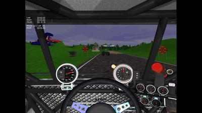

Reply 5 of 19, by ZellSF
Works fine here too:
415.06 KiB
1890 views
Are you using a standard config, with just the resolution set?
Have you enabled hardware acceleration in options? dgVoodoo can't force resolution if hardware acceleration isn't enabled.
And obviously dgVoodoo can't do anything about the 640x480 menus, they aren't DirectDraw/Direct3D.

Reply 12 of 19, by ZellSF
My pictures proves I have the game running at 4K, and that all 3D geometry is rendered at 4K. That's what you asserted wasn't the case.
No one really knows what your problem is, because "image is not sharp" can mean a lot of things. Could for example mean anti-aliasing is on, which is the case in my screenshot.

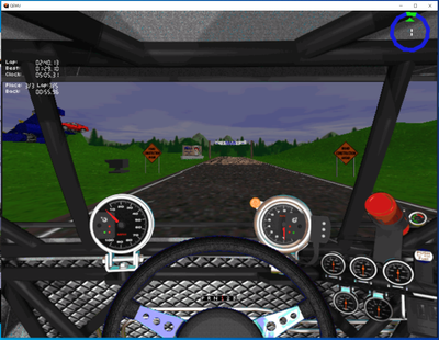

Reply 18 of 19, by kjliew
It looked like you were not using Hardware Acceleration. The game can also run in windowed mode *without* hardware acceleration regardless of your Graphics settings. Press F4 to enter fullscreen to enable hardware acceleration. The screenshot was missing an upper-right circle.
QEMU rendered at upscaled 1400x1050
1.38 MiB
1396 views
