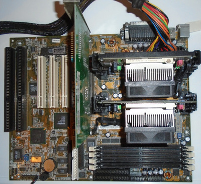

I am collecting bits and pieces to finish my build, I want to use dual slotkets and dual FCPGA or FCPGA2 CPU's and would be grateful for advice on heatsink/coolers.
On the Asus dual slot 1 P2B-D & DS what is the clearance please if anybody knows from the top of the CPU die (assuming an exposed/naked die CPU) and from the top of the IHS (on the type of CPU with an IHS) to the back/read of the adjacent slotket.

Reply 4 of 22, by PC Hoarder Patrol
This is how I've currently got my P2B-DS kitted out
997.27 KiB
560 views
Two MSI MS-6905 Mater slockets & two Coolermaster DP5-6G11 (known in some markets as the CM DRACO Slimbird GP) but with uprated fans (Gelid Silent 6).
The gap from the base of the rear heatsink to the back of the front slocket PCB (for this to work had to remove the plastic backplate from front slocket) is 50mm, and the heatsink / fan combo is 43mm. I'm using bare die processors so with IHS would be probably 1mm difference.
Reply 5 of 22, by limsolo
PC Hoarder Patrol wrote on 2020-09-08, 20:05:
This is how I've currently got my P2B-DS kitted out […]
Thank you for such detailed information this will help me a lot!, if I may ask you a couple of questions as your setup is practially what I am aiming for.

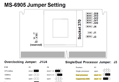

Thanks again, on J3 looking at the instruction manual for the v2.0 MS-6905 (the only one I am aware of with TVC chip & 3 pin J3, though as you said have a different version which is not something I have seen mentioned any place 🤣), it says SMP is pin 2&3 shorted, Coppermine is pin 1&2 shorted. I know the board only officially supports SMP on Celerons in SMP. Therefore once the wire is soldered on (do you have to do this on both boards or just 1?), which jumper position on J3 do you select, I know you have to short pins 2&3 otherwise it would be pointless soldering the wire on but is another jumper on pin 1&2 of J3 required for Coppermine CPU (logically the answer is yes as you have Coppermine fitted in your boards) meaning that 1&2 and 2&3 are jumpered at the same time in your case?
Out of curiosity do you know what the difference is between yours and a d03, what clock generator IC is on yours?

MSIs version numbering on these seems slightly screwy at times - as I said, mine are nominally v2.3 - one is marked as 2.3 (sticky label) & one as 2 (silkscreened on PCB) but they're identical down to age, layout & individual component numbers (maybe from different fab houses?). Not sure I've actually seen a pic of a v2.3 with the 4-pin J3 but I've seen them discussed on other forums - apparently the 4-pin version does away with need for the J3 / N33 wire mod.
To make it work properly, I've wire-modded both mine and they're also both single jumpered on pins 1-2 on J3 (Coppermine 256k, as 2-3 is reserved for dual Celeron only). What you're describing is actually how the 4-pin version works - dual Coppermines are jumpered on 1-2 and 3-4.
Differences on these boards can be hard to pin down without actually seeing them, as quoted on that web page I linked you to in an earlier thread...

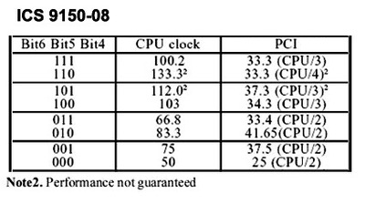

The P2B-D rev 1.06 D03 that I have here does not like 4x256 sticks when there are two 1GHz 1000/133 SECCs installed. Recognition is erratic, sometimes 2, sometimes 3. With fsb 100 Seccs there is no problem.
Re the 112 fsb, according to the specsheet of the ICS 9150 the performance is 'not guaranteed'. And at 112 fsb the PCI is overclocked wich may also cause instability?.
I guess that your system would improve with replacement of the ICS 9150 with the later/better model.
