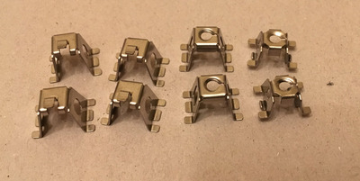

Those are specific to the case. Most that use those have screw in standoffs along the back and use those toward the front with special punched area's in the mount plate that allows them to pinched into place depending on the motherboard.
Have a few and there is no hardware store or 3D printable replacement that would work due to them being as thin as razor blade where they "pinch" into the case mount plate.
Best thing is to drill out the mount plate where needed and then use texterted idea with modification.
If you drill out the plate then use brass stand offs with micro nut on back of plate, and then use standard board screw to stand off it will work just fine. Just make sure you use proper height stand off.
Been there and done it but have also saved every one of those mounts could find as they are very case specific.
Here are some variants of those mounts I have: (and no cannot spare any sorry)
