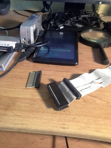

You can get adapters to go from a normal fdd ribben cable to 5.25" drive connectors/contacts. Older fdd cables have both types of connector on them . Maybe a Vogons member close by could supply you one for just postage. Those of us who have been using these ol systems for a while will have at least one box full of various fdd cables.

Reply 9 of 33, by Caluser2000
AlessandroB wrote on 2021-06-04, 18:59:
it can be handled by a modern PC with mainboard floppy connector (SocketA) or need a old computer?
With this drive you can read/writhe every 5 1/4 format/capacity floppy?
tnks
It's not a good idea to format 360 floppies in 1.2meg 51/4" drives because of the way the drive sets up the disk. They will be hit and miss if trying to read in a 360k 51/4 drive. 1.2meg 51/2" fdds should be able to read 360k and 1.2meg 51/2" ok Just be aware t hat even some fdds wont read a floppy because of the fdds head alignment on the fdd that created the floppy is different than the fdd reading a floppy disk. Reading a 360k disk that was created on a 1.2meg fdd should be ok.
Folk go for fdd emulators and using disk images to make life easier. No head alignment or cleaning needed. But first you need a real fdd drive to create those disk images 😀
