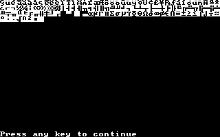

Well, I had looked at your code, but nothing struck me as being incorrect except the SCREEN 12 for CGA, so I figured the problem would be something less than obvious that requires debugging.
Anyway, I pasted your code with the modifications for CGA into a .BAS file and ran it in QB 4.5 (with /l command line switch to load QB.QLB for the INTERRUPTX function), and this is a capture of the screen in DOSBox 0.74-3 (looks the same in SVN) with the machine=cga setting:
1.89 KiB
1378 views
It seems to work as expected, at least to my understanding of what you expected...
Reply 14 of 16, by Peter Swinkels
@ripsaw8080:
I checked again. It works, that is the first time around. (try running it multiple times) After that the characters get corrupted. I have no idea why. Do you (or anyone else) has any idea why?

Reply 15 of 16, by ripsaw8080
Rank DOSBox Author
DOSBox Author
Likely because you don't set the INT 1Fh vector to point back to the characters in ROM before your program ends, so on subsequent runs you copy from where your font variable was located on the previous run, which won't necessarily be the exact same address for each run.
Of course you should always set the vector back to ROM when your program returns to DOS, because the memory for your "custom" font has been returned to the system as free memory.

@ripsaw8080:
D'oh! You're right of course, silly me. I fixed it so it now restores the original vector. And guess what? It works! Thank you!
