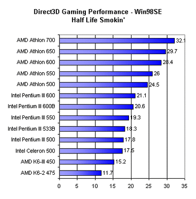

The 700 MHz Athlon Classic performs well compared to earlier Pentium 3s in AnandTechs test. All Athlon CPUs running at 700 MHz or below are set to a 1/2 L2 cache divider.
The Athlon 750 – 850 featured a 2/5 L2 cache divider that resulted in L2 cache speeds ranging from 300 MHz to 340 MHz and the 900 – 1 GHz a 1/3 L2 cache divider that kept the L2 cache frequency between 300 MHz and 333 MHz.
https://www.anandtech.com/show/386
