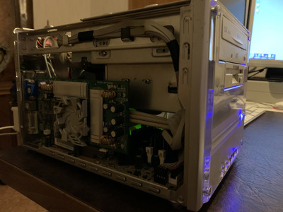

Reply 9 of 43, by dr.zeissler
This is how it looks like.
Reply 10 of 43, by kolderman
That case has poor airflow tho and is cramped. I would not do that to a valuable card, maybe a MX440 or something.
Reply 11 of 43, by Putas
If the FX 5500 is 128-bit, I will choose her for similar performance but with more options.
Reply 12 of 43, by The Serpent Rider
dr.zeissler wrote on 2023-01-11, 18:26:
You'll just ruin it eventually.
Reply 13 of 43, by iraito
That can't run passive, even a passive low profile GPU would struggle if the rest of the system gets too hot, if anything i would mod the case to improve and add airflow.

Reply 17 of 43, by Garrett W
Can't you install a small, silent Noctua fan on the card? They are a bit expensive, but they are very silent, I've seen people mod Playstation 2 consoles with said fans.
Reply 18 of 43, by dr.zeissler
Garrett W wrote on 2023-01-11, 21:24:
perhaps...but don't know how to mount it.
Reply 19 of 43, by The Serpent Rider
ZIPTIES 🤣
