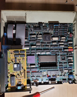

Reply 1 of 16, by weedeewee
No clue about the bios, closer examination of the bios code could give more insight.
I see this board is also not listed on theretroweb.com .
You could help the community out by posting some clear photos of the front & back of only the motherboard .
Even better if you can read out the bios and post it as well.

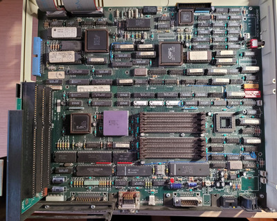

Reply 2 of 16, by makary23
I am attaching a detailed photo of the board - Leopard Motherboard REV B.
I have also attached the BIOS file that I found on the internet.
    804.99 KiB
    920 views
    Photo of Leopard Motherboard
    apxeni.zip
    38.36 KiB
    39 downloads
    BIOS Leopard Board

Reply 4 of 16, by weedeewee
Seems the bios isn't really compressed, and there's just mention of using a setup program.
I guess you'll be hunting for some original software to set it up, or some generic software to setup the cmos entries.

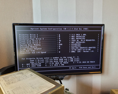

Reply 8 of 16, by konc
makary23 wrote on 2023-02-10, 12:48:
Am I to understand that the BIOS configuration can be done by an external program? For example from a floppy disk?
Correct, since you don't have the original software you can try some generic CMOS utilities that allow setting up the basic stuff.
Nobody here can be 100% certain that there isn't a built-in UI, but at this point the external utility looks very probable.

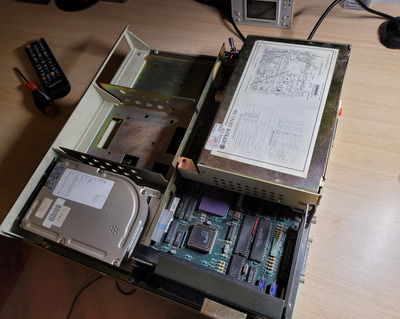

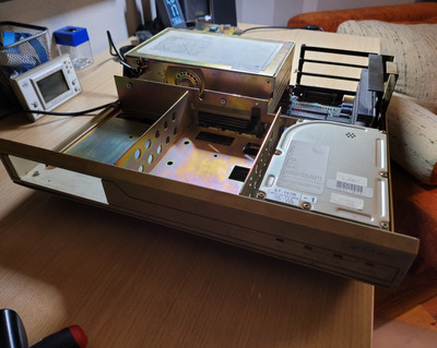

Reply 9 of 16, by rasz_pl
is there a possibility it needs a BIOS command to start HDD rotation? or are those hard wired to always rotate? Might need some oil dripped into bearings and gentle persuasion (tap tap), might also got head welded to the platter and will get ripped off if you force it to move (seen few of those on YT).
Reply 10 of 16, by makary23
konc wrote on 2023-02-10, 13:23:

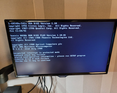

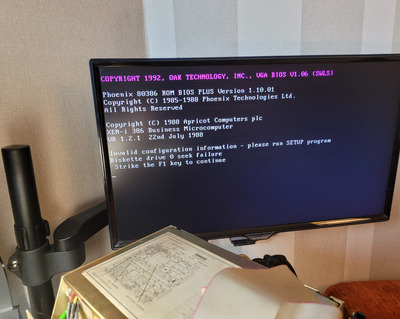

It will show what screen I have at startup. It says SETUP program. Maybe it needs a program or maybe not? Can anyone confirm this?
    1.41 MiB
    851 views
    Startup Screen
Makary23
Reply 11 of 16, by makary23
rasz_pl wrote on 2023-02-10, 13:30:
Are you suggesting that I disassemble it?

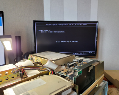

Reply 12 of 16, by makary23
For posterity. I found something like this:
http://actapricot.org/disks/aprididx.htm
apr00001.dsk - MSDOS 3.10 BIOS 3.1.1 MSD.COM VER 2.7.0 29-1-86
BIOS ?
Perhaps it is actually a BIOS graphics program on a floppy disk....
It only shows me an error when booting from a floppy drive (I have a non-genuine one).
Should this hardware have a 720kb floppy drive?
Makary23
Reply 13 of 16, by rasz_pl
makary23 wrote on 2023-02-10, 13:44:
definitely not! get bios in order as it might need a command to start, if still no start try gently tapping it. You can try rapidly rotating it as a last resort, but from what Iv seen welded head is game over.
Reply 14 of 16, by makary23
rasz_pl wrote on 2023-02-10, 14:18:
I will do as you advise. the disk is spinning!

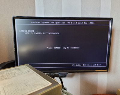

Reply 15 of 16, by makary23
Thanks for all the advice. The computer is booting from the floppy disk. I can enter the BIOS through the setup program from floppy disk.
Piotr.
