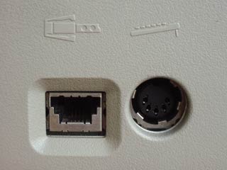

I am setting up my first vintage PC and now I am wondering how I should connect the peripherals. The computer has this weird connector for mouse (see the photo) I have no idea what it is, but for keyboard it has DIN which I can adapt to PS2.
But there in start the questions. As I see I have these options:
1) Get an old keyboard with PS2 and a serial mouse. Downside: most likely not-the-best rubbery keys and ball mouse. If they break the same process of sourcing parts again. Can be expensive.
2) Somehow adapt modern USB peripherals. Downside: is it even possible? Some USB keyboards support PS2, but they are probably not manufactured anymore./
3) Build diy a keyboard, with new switches but old type of connector. Downside: a lot of work.
How have you guys solved this?

Reply 9 of 14, by dionb
Isn't that just a regular AT DIN keyboard connector? The mouse is pretty obscure, but the keyboard looks utterly normal. AT DIN and PS/2 are identical in terms of protocol and voltages, a passive passthrough adapter is all you need. Second the idea of just using a serial mouse in this case.

Reply 11 of 14, by rmay635703
Babasha wrote on 2023-06-27, 23:04:
Its a HP-HIL mouse port((( Rare and unusual thing. Just use the COM-port serial mouse.
Gotta wonder why the ps2 breakout for that wasn’t reverse engineered
It appears to be mostly ps2 compatible as is, I doubt the logic is even as complex as the XT to AT keyboard adapter
Reply 12 of 14, by doublebuffer
megatron-uk wrote on 2023-06-28, 17:51:
Plenty of solutions to use modern usb/PS2 dual protocol mice if you don't have a ps2 mouse port.
Man that's so helpful! I need to get a few of those adapters and try them out. I read from the internet they would not work with modern USB peripherals, good thing I asked here before paying 30 euros for a serial mouse (the only offer for such mouse I found locally).
