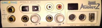

I'm looking for an awesome X-FI sound card to connect to the Audigy 2 Breakout Box, SB0250. It seems like X-FI Titanium SB0880 will not connect as the SB0250 needs the standard 40pin IDE connect and the SB0880 doesn't have it. However, X-Fi XtremeMusic, SB0450 can connect to SB0250. Are there any other X-Fi sounds cards that can connect to the SB0250 and can anyone confirm this? I'm going to throw this into an XP box. Thanks!
Audigy 2 Breakout Box SB0250 download/file.php?mode=view&id=186004

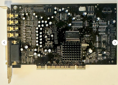

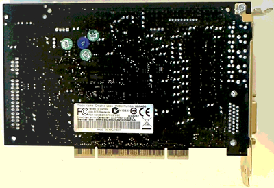

The SB0460 (XtremeMusic) is probably what you mean, rather than SB0450 .
Essentially, any PCI (not PCI Express) X-FI card that has a 40-pin header should work.
Beware of OEM variants : Re: Front Panels Compatible with Sound Cards with EAX for WXP

The XtremeMusic and I think, XtremeGamer would work as well. They have the 40pin connector. Maybe they are both SB0460. I'm getting a bit confused with how people are labeling these cards online.
You said that it must be a PCI sound card, because none of the PCIe cards have the 40pin connector? I did see that with the X-Fi Titanium as well.
How do I know I am not looking at an OEM card? The model number should be SB0460 and nothing else? I'll include a few photos. All of these are definitely a real SB0460 card, right? If it says Creative Labs SB0460, then that is what I am looking for? Is there anything else I need to consider.
