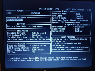

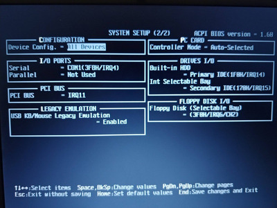

Reply 26 of 32, by Prez
Warlord wrote on 2020-10-19, 22:51:
Post screen shot of microsoft system information. And did you use the driver I linked and put it in C:\Yamaha
You can try inserting a fresh DS.INI and see if it lets you change things. That will undo the settings. in DSSETUP
Hi !
First the bios settings. I did what you told about the Parallel port :
169.56 KiB
1429 views
137.76 KiB
1429 views

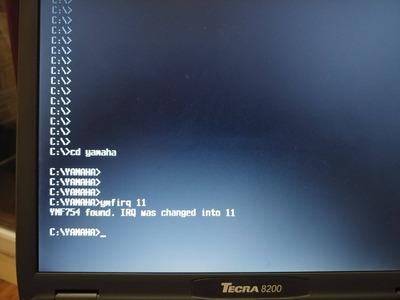

Reply 27 of 32, by Prez
Now when i try to use your files in C:\yamaha and the last ds.ini you gave :
First launch the ymfirq 11 :
95.77 KiB
1426 views

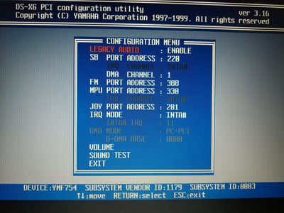

Then i launch setupds.exe and i have this :
238.59 KiB
1426 views

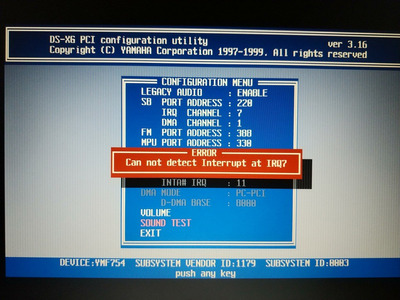

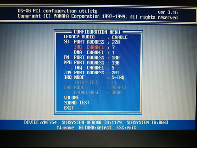

Then i change to S-IRQ and modify IRQ to 7 :
230.79 KiB
1426 views
But i can't save with the typical error message :
195.13 KiB
1426 views

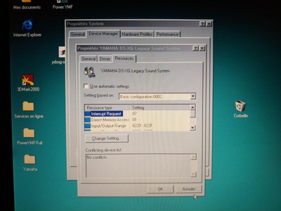

Reply 28 of 32, by Prez
In Windows, i installed the VXD driver and changed the legacy IRQ to 7.
174.3 KiB
1424 views
Every thing is working like a charm ! I can play Doom, Descent, Tie Fighter, Prince Of Persia, Dune either with OPL3 music or XG music, its great !
Old computers and videogames freak
President of french association https://mo5.com
Get better, get old ! 😁
Reply 29 of 32, by Prez
Still no luck under MSDOS whatever i try.
I'm very interested to understand what is wrong with this computer ! 🙁

Reply 30 of 32, by AceMan
Hello, I've been messing around with my Toshiba Tecra 8200 computer for a few days trying to turn it into a gaming platform, with demoscene and AdlibTracker support. This forum has helped me solve some significant problems, so I decided to share some insights 😀
First of all - forcing games to play sound through soundblaster. I have only the newest FreeDOS installed, no Windows.
So, in my FDAUTO.BAT I have entries:
SET BLASTER=A220 I11 D1 T4
SETUPCH.EXE /s
to maintain compatibility with BIOS settings.
And I also disabled serial/paraller ports in BIOS to free IRQ 5 and 7 ports.
SETUPCH.EXE is modified SETUPDS.EXE for this particular soundcard.
SETUPCH settings are pretty standard, "INTA" mode (S-IRQ wasn't working, it was telling me that there are still some conflicts with interrupts).
With this basic setup I am able to launch Adlib-based software (like AdlibTracker2) and demos that let me choose IRQ 11 at startup.
Now for the games, the SWAPIRQ you mentioned comes to the rescue.
For some titles (Mortal Kombat 2) it is enough to change IRQ to 7.
SWAPIRQ /i11 /i7
But for most other titles, it is necessary to manually change the BLASTER variable afterwards.
So before launching the game I execute this script:
SWAPIRQ /i11 /i7
SET BLASTER=A220 I7 D1
And then it works! Of course the game needs to be configured with appropiate IRQ port.
Depending on the game it can be IRQ 7 (Worms) or IRQ 5 (Warcraft, SuperFrog, Day of the Tentacle).
Hope it helps! 😀
