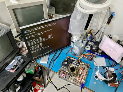

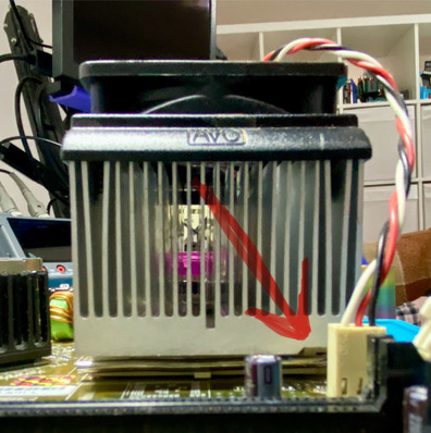

Guys, just an update: As it was suggested above I bought Duron 900Mhz and some no-name cooler for it. I made sure radiator is properly secured and …. despite that I used some contemporary substitutions for all those old VRM’s MOSFETs and I recaped the whole VRM and I flashed in the new BIOS ….after all this the motherboard worked and Duron survived!
I’m sure mobo was all good even before I started replacing things.
The whole issue was just … me 😀

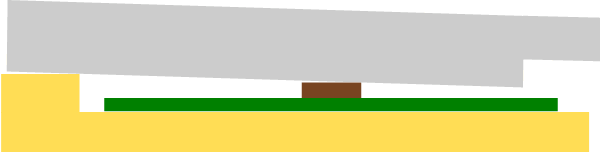

What most likely happened here:
The attachment drawing.png is no longer available
Looking at Socket 370 and 462 datasheets they look pretty much identical. Socket step height is defined as 2.55mm. I was sure AMD cores were lower than Intel ones, but AMD lists Athlon height at 1.917mm REF and 1.777mm minimum, Pentium 3 1.787mm minimum so no difference there. The only option is either putting radiator backwards, or using Tualatin radiator - those have either none or much shallower cutout because minimal heat spreader height is above socket step.

rasz_pl wrote on 2024-11-28, 06:18:
I bought a board with a Athlon 1400. Came with heatsink slanted like that and a lot of thermal paste.
When I removed the h/s I wasn't believing it actually survived.
Cpu is 100% ok and well. The core didn't crack which is almost as incredible.
