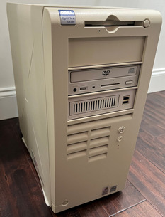

Here is my fully restored and upgraded Dell Optiplex GX300.

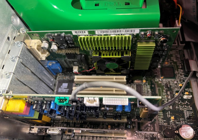

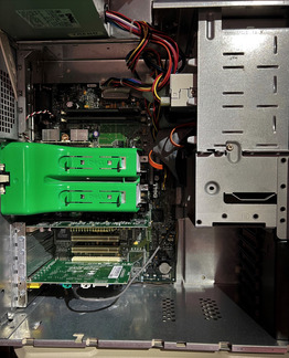

I made the following changes, updates, subtractions while keeping it period accurate (except the HDD) and increasing its capabilities as a workstation (and maybe for playing a game or two!):
Completely disassembled the case, power supply, and all components for a thorough inside-and-out cleaning.

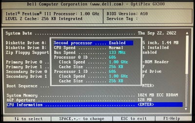

BIOS updated to latest reversion (A10)
Microsoft Windows 98/NT 4.0/2000 Professional sticker (original) re-added to the front bezel
Intel Pentium III sticker (original) re-added to the front bezel
Microsoft Windows 2000 OEM COA (original) sticker re-added w/original Dell copy of Windows 2000 Professional CD and "Getting Started" package.
2x 733/133MHz --> 2x Pentium III 1000MHz/133MHz Coppermine Processors (original heatsinks retained and new thermal paste applied)
2x 256MB (512MB) --> 2x 512MB (1024MB) PC800 ECC RDRAM Modules
Nvidia TNT2 M64 32MB SDRAM --> ELSA GLoria III Nvidia Quadro2 PRO 64MB DDR AGP 4x Graphics Card (Original Dell Part) (new thermal pasted applied to core)
Analog Devices AD1885 Integrated Audio --> Turtle Beach Santa Cruz Crystal CS4630 (Original Dell Part)
Iomega Zip 250MB IDE disk drive --> USB 2.0 w/5.25" Drive Bay Caddy connected to Via VT6202 PCI Card
CD-ROM --> IDE DVD-ROM
40GB Western Digital 5400 IDE HDD --> Lite-ON 128GB NVMe (mounted in SATA enclosure within the 5.25" USB 2.0 caddy w/SATA to IDE adapter connected to the motherboard)

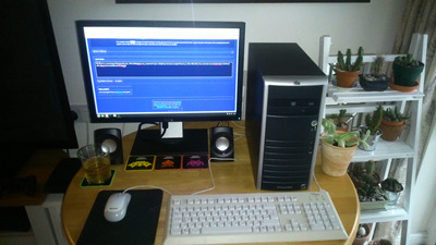

My main PC is a 2008 vintage HP ProLiant ML115 G5. CPU is AMD Opteron 1354, a quad core K10 @ 2.2 GHz(pretty much same as original Phenom x4). 8 GB or DDR2 RAM, it has a somewhat unusual Nvidia chipset motherboard with a Matrox G200 graphics embedded into the chipset. The second GPU is an Nvidia Quadro FX 4600 with 768 MB GDDR3 RAM.
720.16 KiB
641 views
541.27 KiB
641 views
I use an old Sound blaster Live! SBO220 PCI for audio, a Samsung SSD and 2 mechanical hard drives for storage. The display is an Dell IPS 22 inch 1680x1050. The original PSU was replaced years ago with a Corsair CX 430.
Dual boot Linux MINT 20.3 & Windows 7.

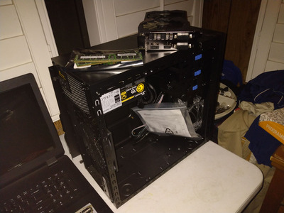

For modern, I'm saving up to build a modern workstation/daily desktop build that I'm hoping will last me the next 10-15 years. IBM POWER9 02CY297 (will later switch out to an 8-core, or a 160w 16-core, whichever is cheaper) in a Raptor CS Blackbird motherboard, with 32GB of RAM and a Radeon RX or Pro W of some description. I have an RX 570 right now slated for it, but due to ROCm 4.5 deprecating Polaris, I'm leaning towards swapping it out with an RX Vega 64 since Vega is still supported by ROCm and thus Blender and Shotcut, and a few years down the line swapping that Vega 64 out with a Radeon Pro W6600 (or W7600) mainly because I prefer single-slot cards and either one will handle RT at the relatively low (320x200 at the low end, 1024x768 at the high end) resolutions I plan on playing the games that are available for ppc64le at. The "workstation" part comes in with me wanting to use it to pick up 3D animation, voice acting, and all that.
Here's an image with the parts.
