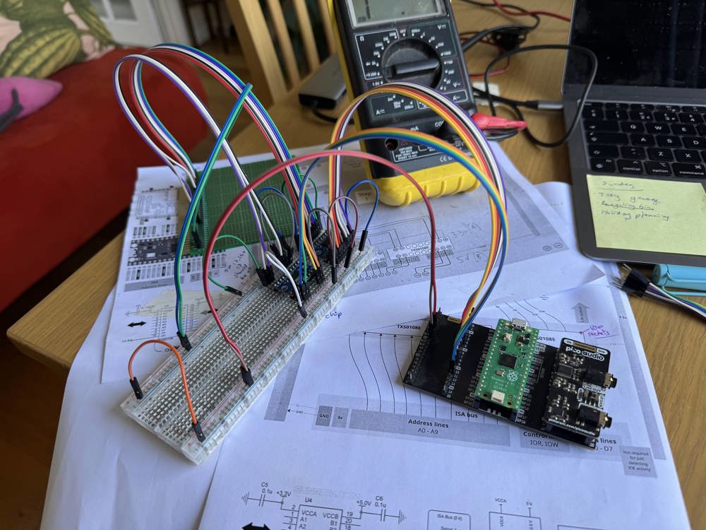

This project has on ice for a few years, due to events in my life. I'm happy to say that I've now resumed work
After some advice from Ian Scott of PicoGUS fame I've been investigating detecting HDD activity directly from the ISA bus, so that this becomes a plug and play device.
I purchased several TXS0108E level shifters to translate the ISA bus 5v to a safe 3.3v for the Pi Pico and wired up a breadboard to the A0 - A9 address lines along with IOR and IOW
img_8250.jpg?width=1000&v=1dc09cc8f245962
After several wiring checks I felt brave enough to actually try it in my computer.
The following video demonstrates what happened on that first attempt!
https://youtu.be/V8H3NL-J_68?si=Dbhm6iBzVk_Q1NyU

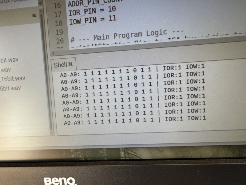

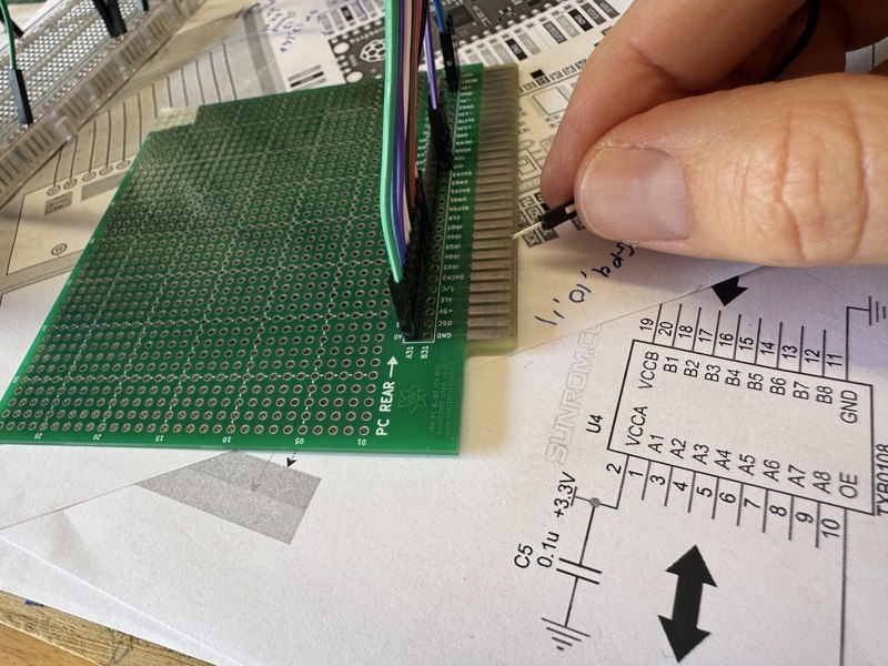

Reply 7 of 82, by MaverickUK
After posting the previous video I found that one of the level shifters was faultly along with the next replacement I then used!
What followed was an exercise manually testing each of the ISA lines on the bench to validate the chips and lines were all working
img_8271.jpg?rmode=max&width=800&v=1dc09faca929e7d
img_8272.jpg?rmode=max&width=800&v=1dc09faca896fc7
Thankfully after all this I was able to return to my 386 PC and after adding in some additional code to ensure HDD activity only triggers after activity reaches a certain threshold. Although some finessing is still required, I'm proud to say that this is a successful proof of concept. HDD activity is being successfully captured by the Pico.
A video of this working is available from https://youtu.be/Tan_0qBtJHs

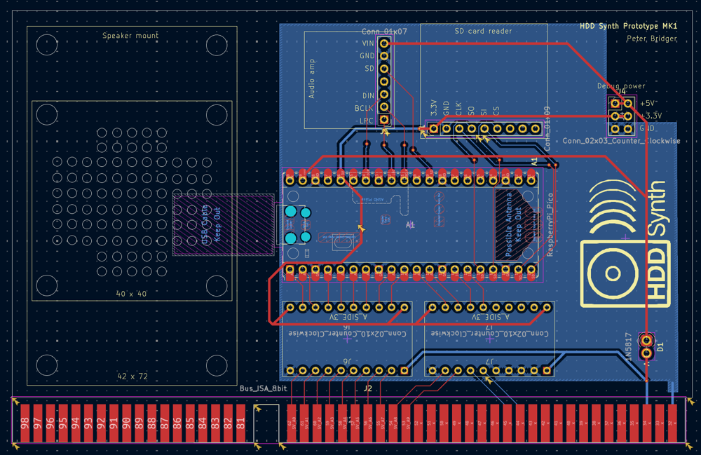

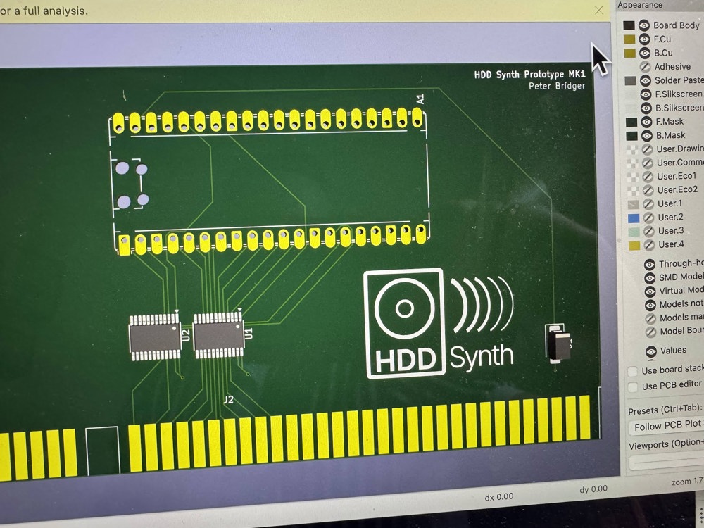

Reply 8 of 82, by MaverickUK
I've been continuing to prototype aspects of the project such as loading audio samples from an SD card so that it'll be easier for users to change the samples
I'm waiting for an Adafruit I2S MAX98357A to arrive to determine if that's an acceptable and cheaper audio out than the Pico Audio Pack i've used so far
Today I've been starting to create the prototype PCB so that I can create some units to send out to people who would like to help me test and refine the device
img_8619.jpg?rxy=0.6340852130325815,0.5958429715599888&width=1000&v=1dc11f273f5f2de
There are still some components to be placed on the PCB, so this is a work in progress.
I did however start to price up 20 x PCBs with the SMD components pre-assembled which came to about $60.
Before I go ahead and place the order with PCBWay would someone be able to validate my designs to ensure I've not made any fatal mistakes. This is my first time with KiCad and PCBWay

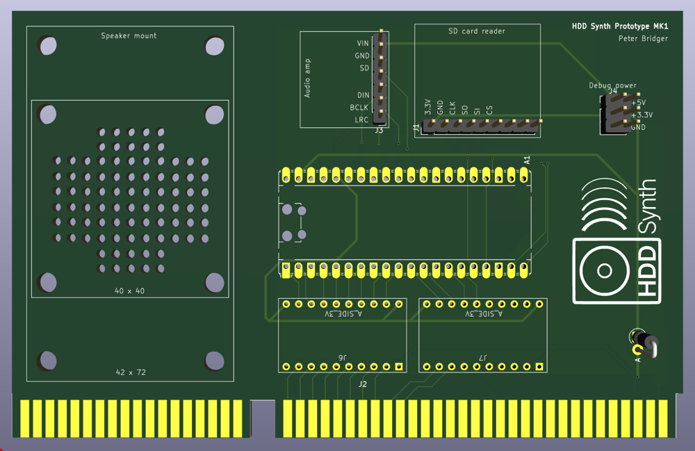

Reply 9 of 82, by MaverickUK
PCB design for the initial prototype is complete and sent off to PCBWay for manufacture.
To keep things are simple as possible for the initial I've changed all the components to be through hole. I'll move to surface mount and a more compact design to the final design.

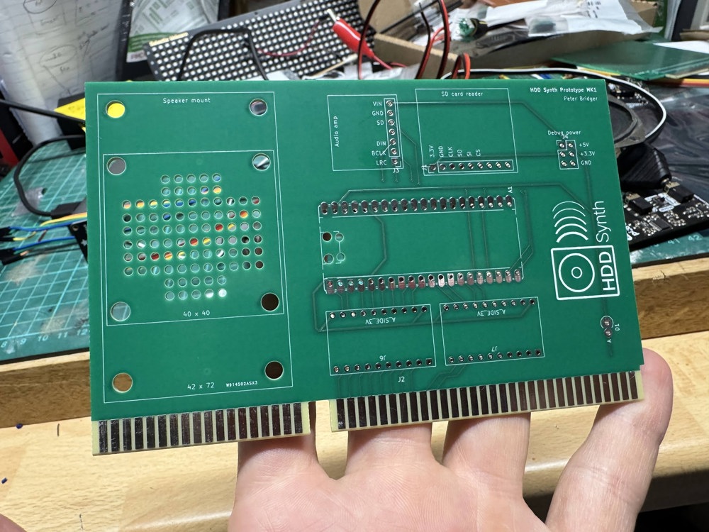

Reply 10 of 82, by MaverickUK
img_8689.jpg?width=1000&v=1dc18c6957b6e72
The first batch of prototype PCBs arrived this morning
img_8695.jpg?width=1000&v=1dc18c6959817ec
A sanity check of the components shows that they all fit their through hole mounts, which is a good start
Next up I'll perform a continouity check on the traces before soldering in the sockets and then testing the PCB using my bench power supply before I get anywhere near putting it into my PC

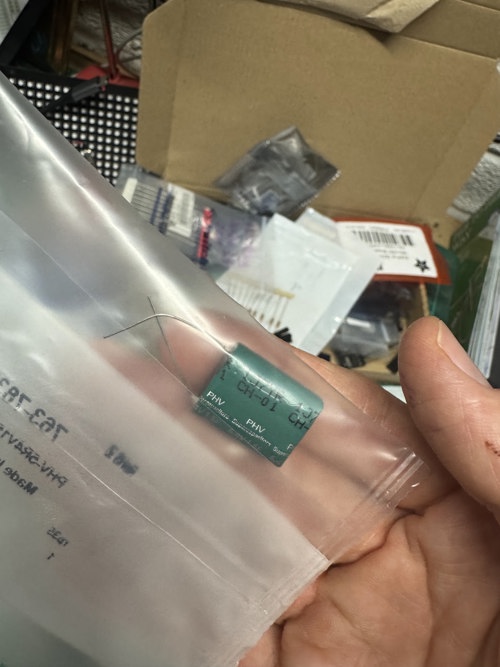

Reply 12 of 82, by MaverickUK
Good thinking ott 😀
I've ordered a few 5.5V 1.5F super capacitors to test exactly this idea out
In theory if I connect them in parrallel to the 5v ISA rail which goes to the Pi Pico VSYS input with a 22 ohm resistor to prevent a sudden load, once charged up it should provide enough power to power all the components after the PC is turned off. The Schottky rectifier diode that is already part of the design will stop the voltage going back into the PC, so it'll only get used on the HDD Synth.
img_8701.jpg?rmode=max&width=500&v=1dc18f5fd506d48
I've bought a quality Eaton brand for this proof of concept work which is quite expensive at around £7
http://www.strifestreams.com

Reply 14 of 82, by ott
MaverickUK wrote on 2025-08-29, 15:09:
Sorry, I didn't think about powering the capacitor. It's not a trivial task in terms of all kinds of protection.
Please be careful, I've seen bad consequences from a faulty diode/capacitor.
It might be worth considering external power supply from USB-C.

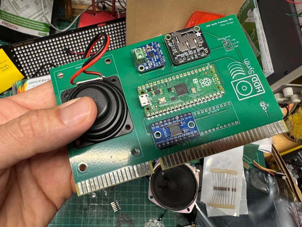

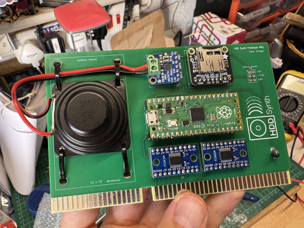

Reply 15 of 82, by MaverickUK
img_8702.jpg?width=1000&v=1dc3a97c90bda32
Behold, the fully assembled HDD Synth
Unfortunately some bodge wiring was required...
img_8759.jpg?width=1000&v=1dc3a97c8f249ac
Long story short, I've decided to take a slightly different route for the MK2 prototype. The full reasons are explained at https://www.strifestreams.com/articles/2025/a … -mk1-prototype/
The next prototype board won't detect HDD activity through the ISA bus and instead will use a direct detection from the HDD LED. It'll still use the ISA card form so that it can draw power and for ease for installation, but I'm planning to make it only use the 8bit ISA slot connector to small it smaller.
I'll likely revisit ISA bus HDD detection again in the future, as I really like the idea of a true plug and play device. However, for the moment this allow me to focus on getting a true MVP developed and released. Ideally in time for Christmas! At least, that's the deadline I'm setting for myself as motivation.
