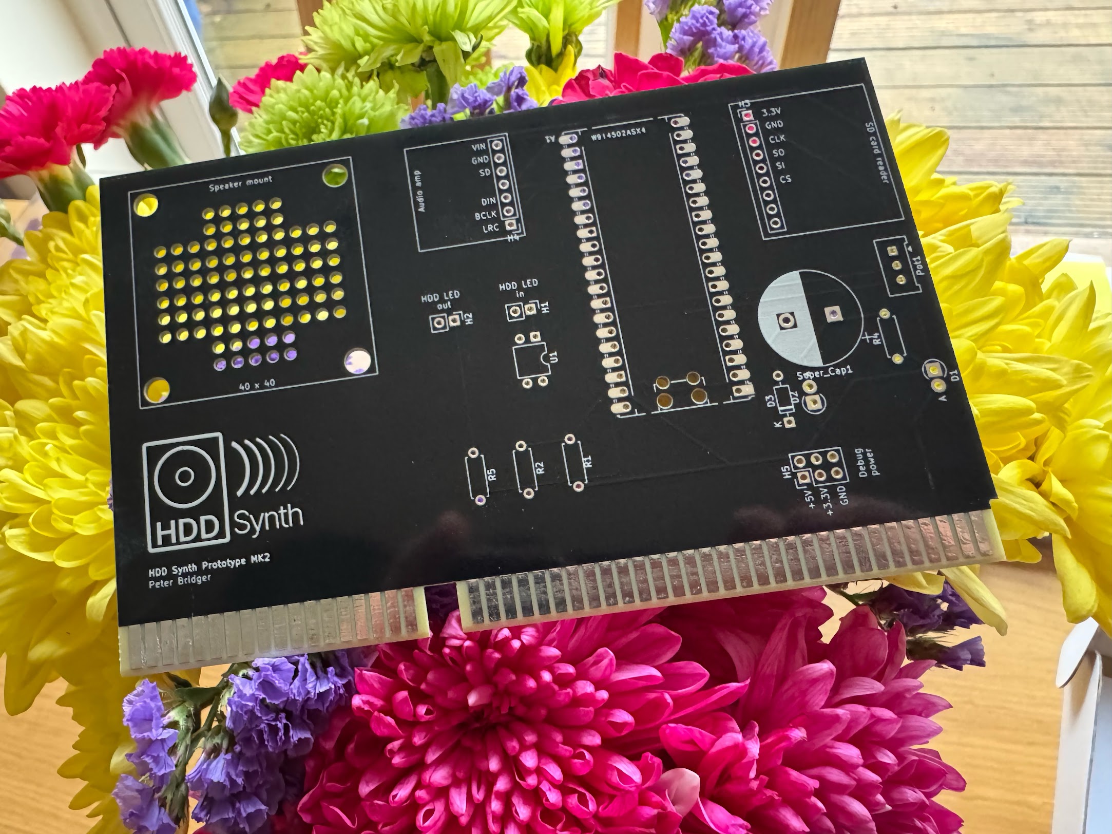

Behold, the fully assembled HDD Synth
Unfortunately some bodge wiring was required...
img_8759.jpg?width=1000&v=1dc3a97c8f249ac
Long story short, I've decided to take a slightly different route for the MK2 prototype. The full reasons are explained at https://www.strifestreams.com/articles/2025/a … -mk1-prototype/
The next prototype board won't detect HDD activity through the ISA bus and instead will use a direct detection from the HDD LED. It'll still use the ISA card form so that it can draw power and for ease for installation, but I'm planning to make it only use the 8bit ISA slot connector to small it smaller.
I'll likely revisit ISA bus HDD detection again in the future, as I really like the idea of a true plug and play device. However, for the moment this allow me to focus on getting a true MVP developed and released. Ideally in time for Christmas! At least, that's the deadline I'm setting for myself as motivation.
