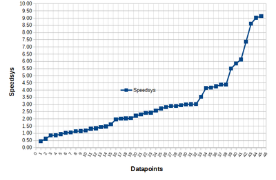

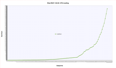

I did these tests years ago, and the conclusion for 'best' slow platform with the largest CPU range without using tools like Moslow and Throttle:

Most flexible from slowest:
1) K6III+ with a S7 supporting appropriate and active Turbo switch (not a SS7)
2) Slot 1/ S370 with an EZRA-T overclocked to 1200+ MHz
3) S7 and K6III+ with board that can change write thru from write back cache for L1 (an extra parameter)
After this, you can use a second board with an unlocked Core2Duo S775 that scales from 600MHz to 3000+MHz, covering 3D games.
Or an unlocked PIII Tualeron/ Tualatin instead of the above, from 200 MHz to 1400+ MHz. Or an AMD Athlon flavour.
Notable mentions:
A) Nehemiah and Slot1 / S370
B) SS7 and K6III+
C) Unlocked PII and Slot 1, with ability to switch write thru from write back L1 cache (extra parameter)

Yes, this info looks to be buried from years ago with all the SS7 hype.

Thank you, @j^aws. Yes, that's basically my experience as well.
Anyway, this is the main idea of this thread: I'm trying to prove that, no matter how one looks at it (from a flexibility/performance/stability standpoint, etc), the Ezra-T + 440BX is superior to a SS7 build.
That does not mean that SS7 builds are bad, far from it. As I said, I also love this platform and have a bit too many SS7 systems myself. However, having used both the Ezra-T/440BX and a multitude of SS7 PCs, I can attest without any doubt in my mind that the former is just better in every way.
