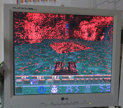

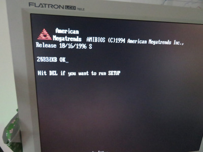

Reply 1163 of 2521, by feipoa
You were planning on using the GD-5428 VLB for the Quake w/audio tests. Are you still able to test this card? There is no issue with PCI cards and the issue with the Trio64V+ is much less prevalent than with the VLB versions of the Mach64 or 5428.
What FSB are you running?
I don't understand how you did not witness a Quake v1.06 slowdown when using exactly 64 MB and either 256K or 1024K. I witnessed this with both of my M919 boards. I tested for this several dozen times and it was always there, and on both boards. What BIOS are you using? I am using this:
The attachment M919_BIOS.JPG is no longer available

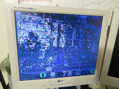

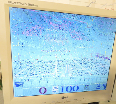

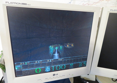

This is what I see. Sometimes, subtle like a colour swap here. Usually with the Trio64V+
The attachment IMG_9728.JPG is no longer available
But with the GD-5428 or Mach64, I more commonly and frequently see these, but it doesn't stay like this:
The attachment IMG_9741.JPG is no longer available
The attachment IMG_9734.JPG is no longer available
The attachment IMG_9730.JPG is no longer available

Reply 1166 of 2521, by pshipkov
Ok. With Cirrus Logic VLB cards i see the same problems as you shown above when sound is on - tried with 5426 5428 and 5434.
So weird.
Tried also with GD-5480 PCI and few S3 Virge versions - all came clean.
Finally.
I confirm that Quake 1 freaks out on this board when 64Mb RAM is present. Regardless of amount of L2 cache and other parameters.
Don't know what i was writing last night. Going to scratch through that sentence in my previous post.
The rest of the stuff does not seem to be affected by this issue.
You are probably right that it is a Quake specific thing on this mobo.
