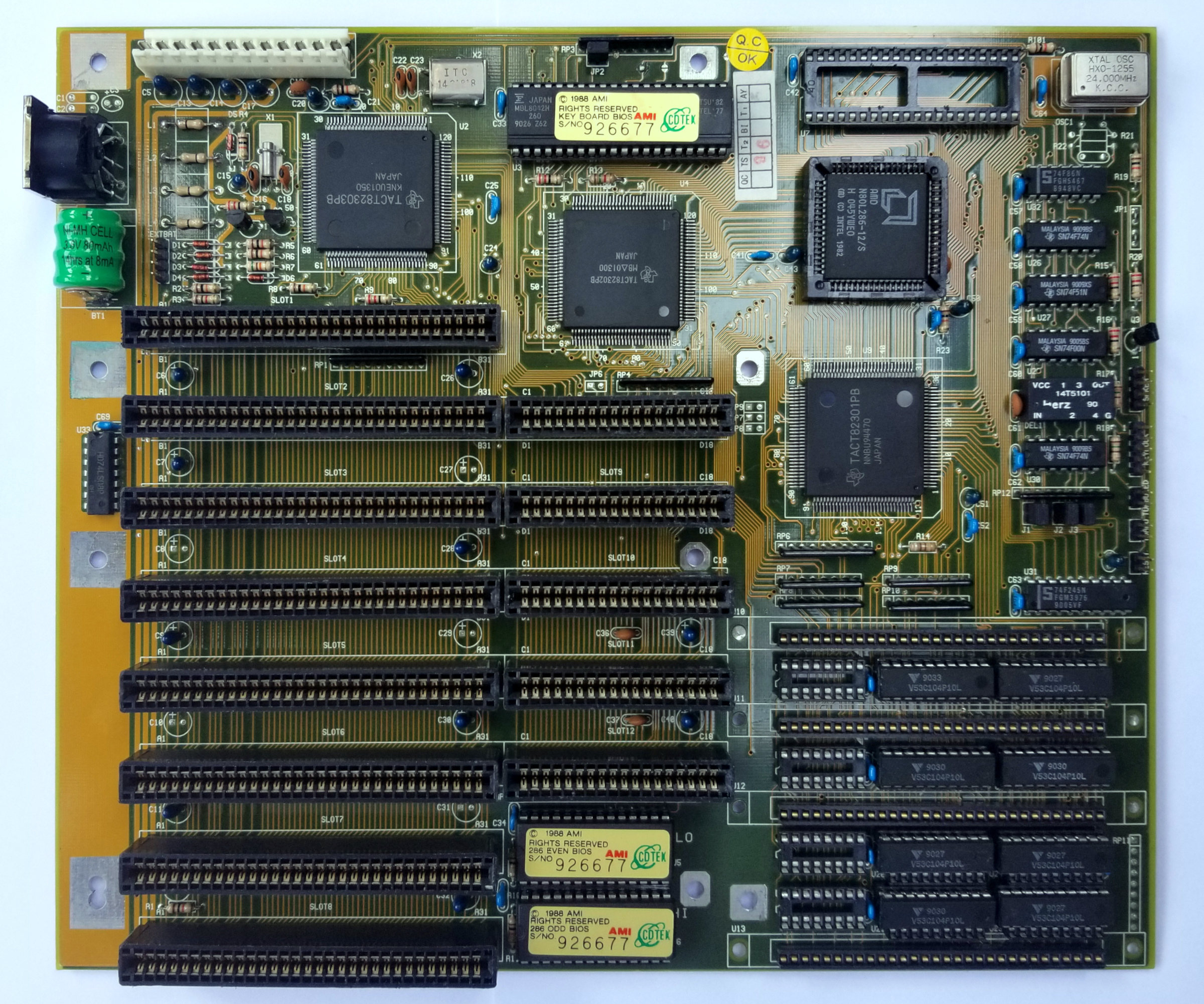

Reply 1304 of 2521, by pshipkov
split-out adapter thread: soj-dip adapter
CDTek 286M, based on Texas Instrument's TACT82301PB/TACT82302PB/TACT82303PB chipset.
After all this time from the late 80ies early 90ies it is still in great physical condition.
Came with 12MHz rated AMD processor.
Does not go a single megahertz above that.
Tried hard with good quality SIMM memory and 25MHz rated Harris/Intersil CPU - no and no.
BIOS offers options for shadowing, memory relocation and EMS.
Even at 12MHz its clock-to-clock performance is unimpressive.
Didn't bother capturing performance metrics.
Works fine for what it is.
