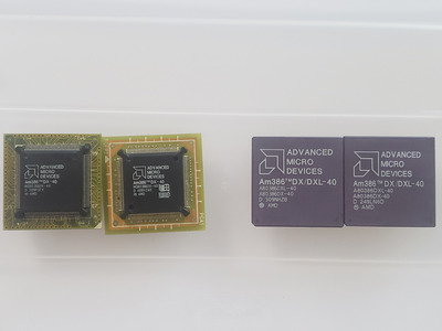

I tried 4 CPU's this time, 2 CPGA's and 2 PQFP's. Both the CPGA's pass at 50mhz, while both the PQFP's fail. Last time I had 2 CPGA's and 1 PQFP (all different), all of which failed.

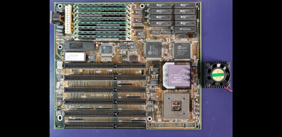

The glorious 386DX-50 setup. Note that I used a 12ns tag SRAM to be safe, but I think 15ns will do. Heatsink + fan are necessary however; fortunately 486 coolers can be permanently mounted using a custom adapter bracket.

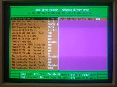

Tightest timings, almost: DRAM needs 1 WS. Maybe 50ns SIMMs can do 0 WS, if 30-pin versions even exist? ISA bus overclocks to CPUCLK/4 = 12.5mhz, really boosting video speed.

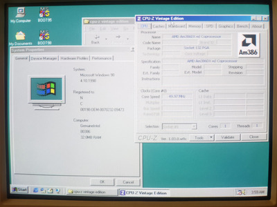

Windows 98 (yes, 98) runs surprisingly decent, though it does take some tricks to install on a 386. The hardware also passes a final stability test: installing NT 3.51.

Overclockers on the right, non-overclockers on the left

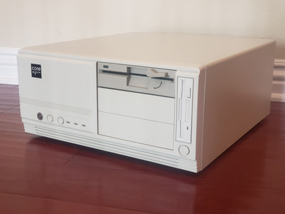

A very clean AT case to top it off
