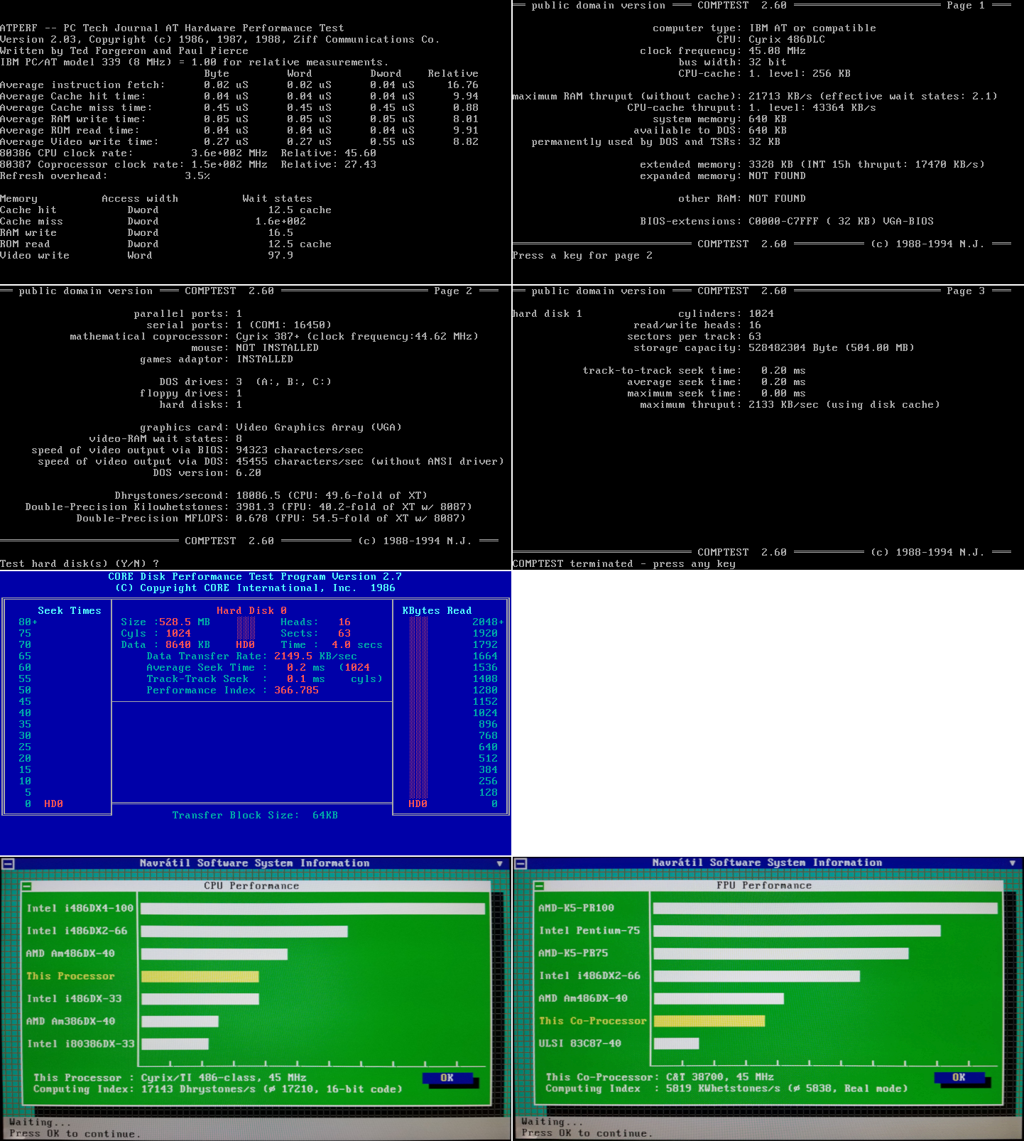

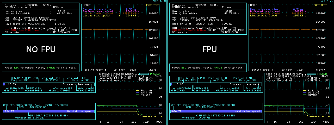

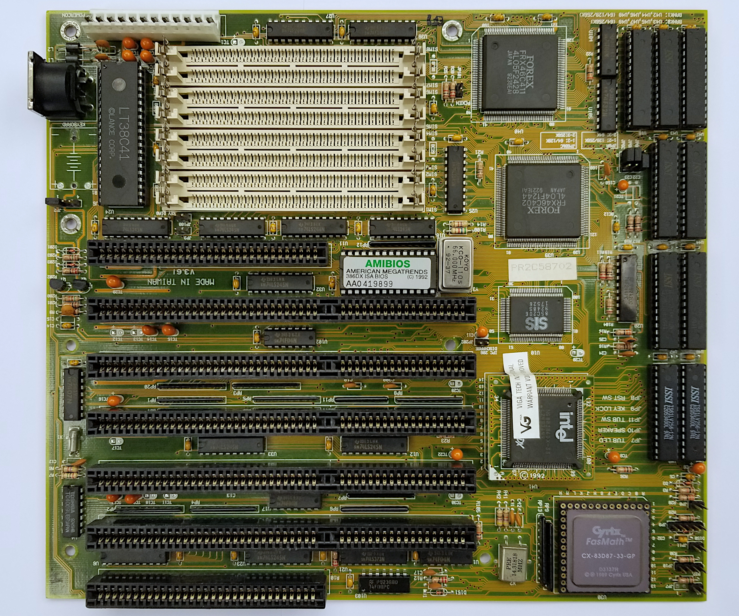

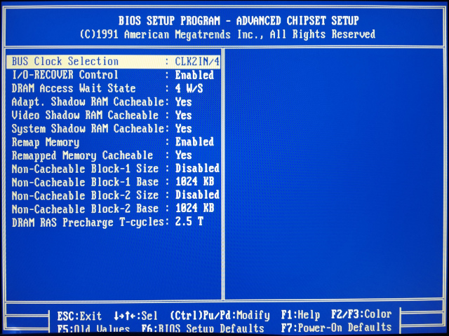

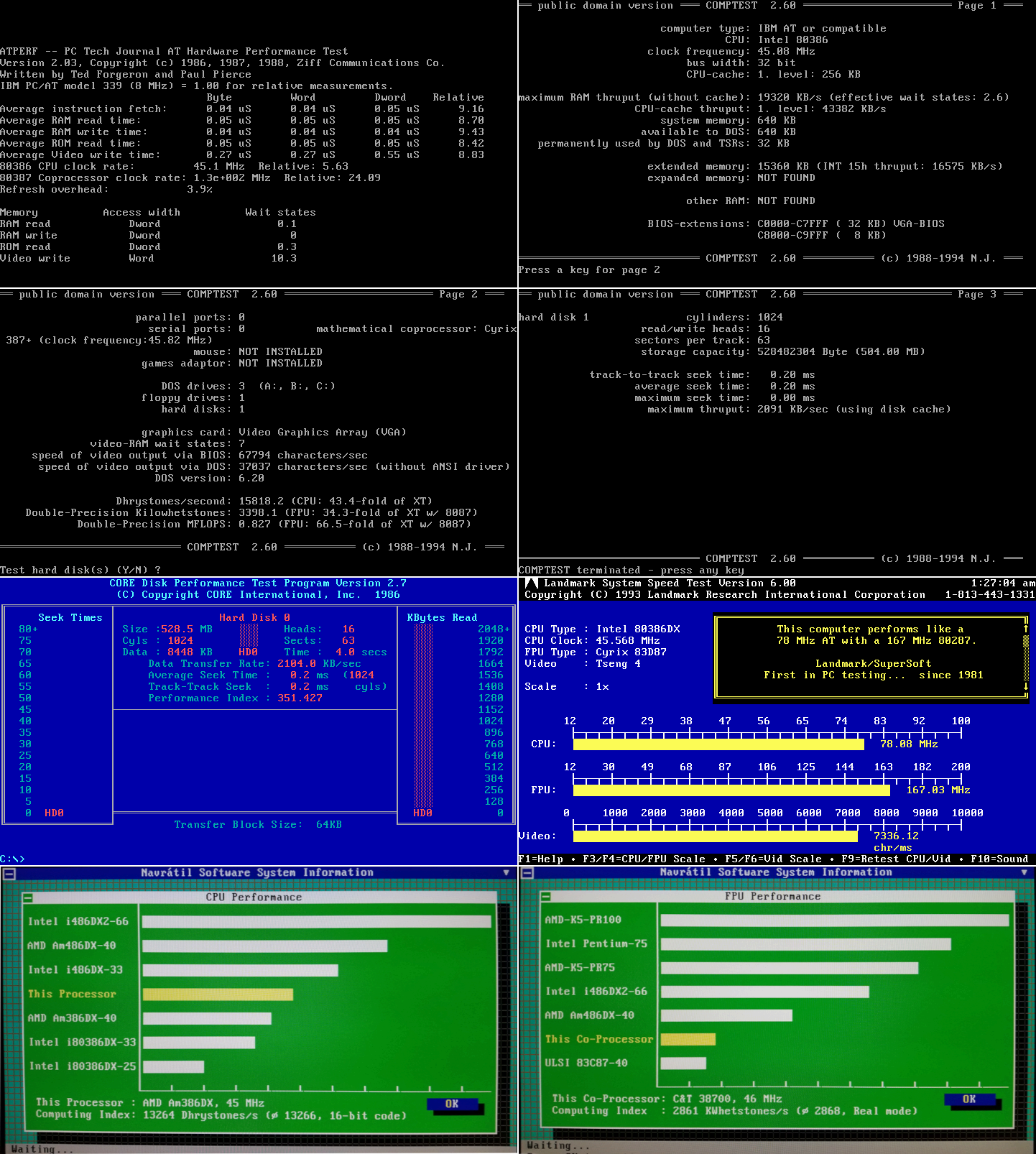

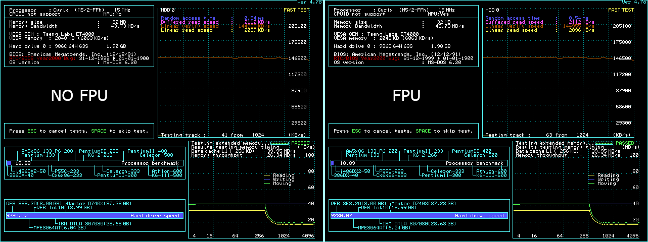

Micro Express Inc. Forex 386 Cache v3.61 based on Forex FRX46C411 / FRX46C402 chipset.
There is information online touching on Forex based assemblies but without providing concrete metrics.
In addition to that, some people hold them in high regard and their comments make me curious.
Decided to check some of that myself - performance and CPU upgrades support.
Few notes about 386 Forex chipsets:
The 411/402 model is a middle generation.
There are 2 later versions:
FRX46C421A - more integrated than 411.
FRX46C521A - single-chip implementation.
The 521 one is seen on very late 386 boards with integrated clock generator limited to 40MHz which makes them uninteresting for overclocking exercises.
The 421 based PCBs are definitely worth exploring, but for that i will need to find a working replacement for the already dead board here.
With that said - these chipsets seem to have relatively shorter lifespan than the average hardware from that time.
In addition to the 2 more Forex dead boards here (one 411 and one 421, partially scavenged for parts) i often see Forexes on sale for parts online.
Luckily the one in question is still alive and kickin'.
Partially upgraded system with 10/12ns rated L2 cache chips and FasMath gray top FPU, but original CPU and clock oscillator still in place.
Assembly seems brand new. I suppose it was put in a computer and never touched until again until now.
It is kind of nice when i am the first person to remove CPU and L2 cache chips after they got inserted in the factory.
But also, it feels somewhat inappropriate to intrude on the "pristine" assembly.
... did it anyway.
Took some effort to max-out and stabilize the system at 45MHz.
It is on the edge with 32Mb RAM and 256Kb L2 cache.
50MHz is impossible under any circumstances.
Some of the BIOS settings had to be lowered but still performance is still better than 40MHz with tighter timings.
I/O RECOVER CONTROL must be ENABLED or no boot into DOS.
Chipset/BIOS don't recognize BL3 CPUs. Only SXL2 and DLC.
Same applies to Cirrus Logic GD-5434 video cards - instabilities.
A bit disappointing.
Tested with AMD 386DX and TI 486 SXL2 processors, as well with video cards ET4000AX (DOS) and ET4000/W32i (Windows).
Here is what SpeedSys shows for 386DX (incorrectly shows frequency as 50MHz, it is 45MHz):
And some more stats.
SpeedSys for TI 486SXL2 (incorrectly shows CPU model and frequency, they are TI SXL2 at 45MHz):
One thing is immediately clear - IDE performance is clearly lacking.
