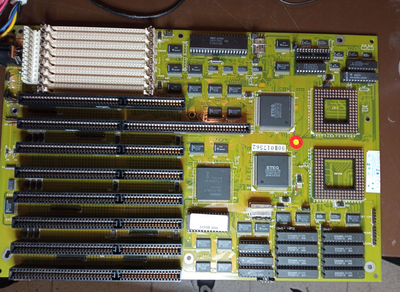

Reply 301 of 427, by dataino.it
Unknow board ETEQ 82C491 82C492
