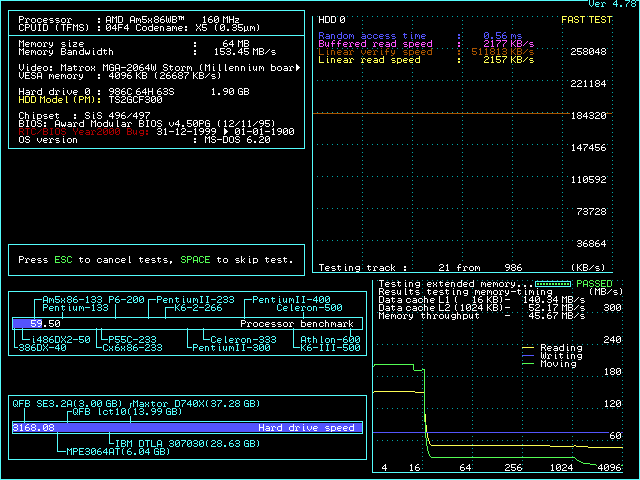

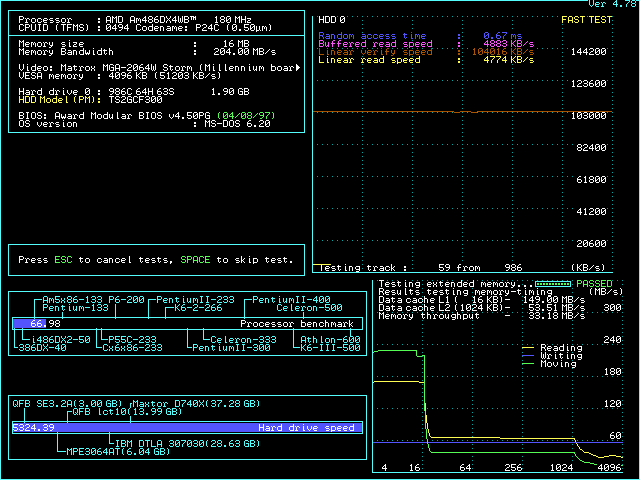

Hey Gonzo,
M919 is clunky but not that clunky.
Something does not feel right there.
I don't use cachecheck so cannot comment on its reliability.
One easy way is to run SpeedSys and see what the memory performance diagram looks like.
You should see 3 cascades - L1, L2 and bare memory speeds.
If you can - post a picture of that.

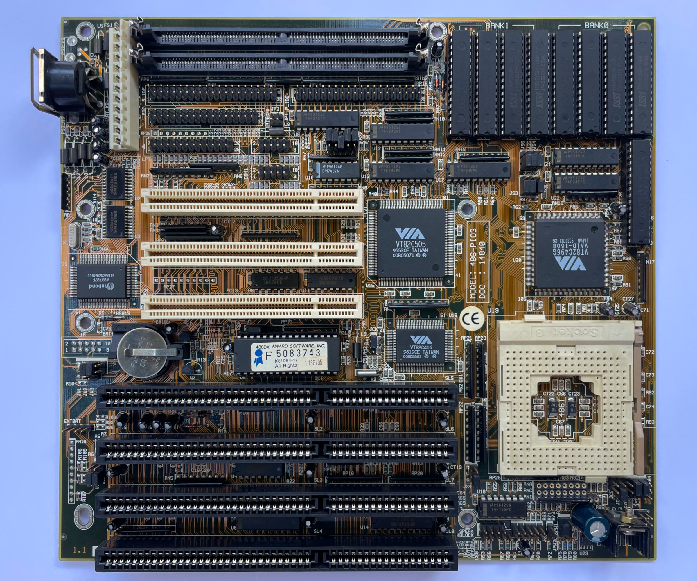

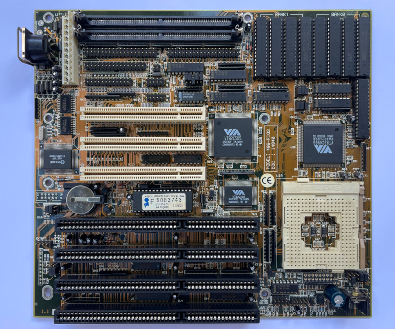

Reply 1556 of 2351, by pshipkov
One more 486 motherboard with 1024Kb level 2 cache.
FIC 486-PIO3
An entirely trouble-free experience !
Based on previous encounters with FIC 486 class hardware i expected the usual set of problems related to fussy L2 cache handling, weird/missing CPU voltages, messy jumpers, instabilities with tight wait states.
Not this time. FIC got it right with their last in line model from the PIO series.
Seems to take any L2 cache chips with ease (impressive). Cache policy is WB for best performance.
Does not support EDO memory, FPM only.
Latest BIOS. Limited options.
Slow on-board IDE controller. You don't feel it with CF cards.
Voodoo3 cards work.
Nice range of CPU voltage options - 3.3 / 3.45 / 3.6 / 4 / 5.
Very simple jumpers.
And that's pretty much it. Stuff just works.
--- Am5x86 @160MHz (4x40)
All BIOS settings on MAX.
What SpeedSys says.
I don't trust this test at all, but notice the L2 cached vs raw memory read speeds. Flat curve.

--- Am5x86 @180MHz (3x60)
Default 3.45V to CPU.
Gets a bit picky about RAM modules. Quickly found 2x16Mb that worked well.
No bus divider needed.
All BIOS settings on max, except CACHE TIMING CONTROL = NORMAL (best is TURBO, can be FAST for DOS interactive graphics tests but fails at complex offline computation tasks).
And that's pretty much it - system is very stable.
SpeedSys.
IDE controller jumps 2x in perf it seems.
Much bigger difference between L2 cached and raw memory reads.

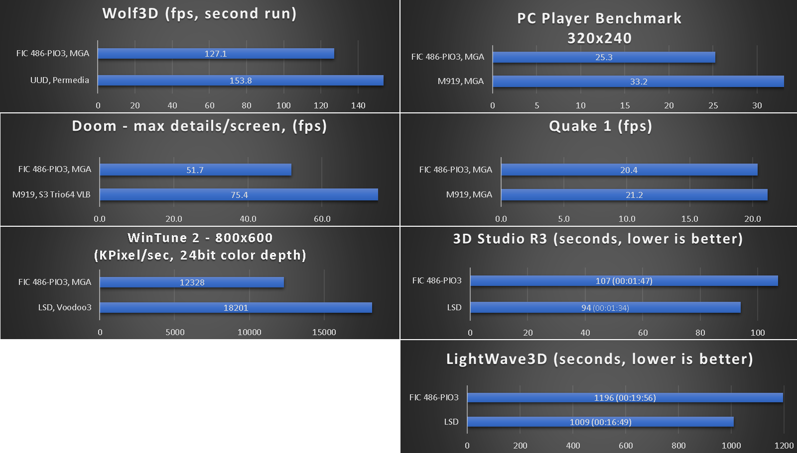

The usual set of benchmarks.
Tested with Matrox Millennium PCI.
Compared against the best performers in each discipline.

Updated the comprehensive POD100 extensive testing, summary post with the PIO3 data.
Not the best performer on a clock-to-clock basis.
The added wait states contribute to very good system stability.

Reply 1557 of 2351, by feipoa
haha, fast memory or slow cache, which one?

Reply 1558 of 2351, by pshipkov
L2 cache read speed is too low. The RAM number is inline with the expected. Looks like very conservative wait states.
