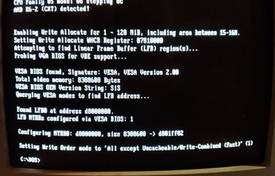

Nobody has mentioned write combining yet, which can boost the performance in higher resolutions. If your K6-2 CPU core is CXT, this can be done with K6INIT in DOS or Central Tweaking Unit in Windows. Still, it won't truly outperform a Mendocino Celeron CPU (BTW, it also supports write combining via P6-style MTRR) which has a pipelined FPU that the software renderer of Quake and likely the Fusion emulator does take advantage of.
Reply 21 of 28, by theelf
Gmlb256 wrote on 2022-12-20, 02:37:

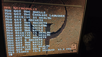

Hi! thanks, i tested K6init no performance gain at low resolution, in Quake, but a big speed up in 640x480! from 11.2 to 21fps, thanks!
181.03 KiB

Reply 22 of 28, by Gmlb256
theelf wrote on 2022-12-20, 03:30:
Hi! thanks, i tested K6init but no performance gain, not in quake or Fusion. Im doing something wrong?
No, you didn't do anything wrong. I see that write combing gets successfully enabled for the LFB region in the integrated SiS video chip and that only works with SVGA/VESA video modes. There is also the /vga command line switch (don't use it if B000-B7FF region is used for UMB) that enables write combining for the memory region used in standard VGA video modes.

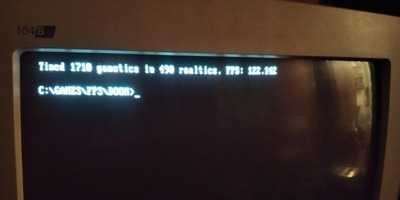

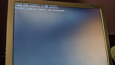

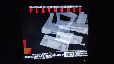

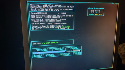

Sorry for my late tests. I lied, I do have K6-II 400 not 450.... Anyway, here are some test results. I doubt that K6-2 are slow. Problem is your IGP and that's why IMO you are having those issues... Plus You have a frankenstein small PC not a regular one (for example so-dimm ram). Try to disable somehow this bloody integra. Maybe in BIOS you can set ram amount to 0 which will.mean that it is shut down..
Test made without univbe, FSB 100Mhz, 512KB cache, S3Savage4 8MB, mobo Freetech P5F93, 512MB RAM.
Quake 320 1.06, Doom High, all other test for fast PC's (Phils benchmarks)

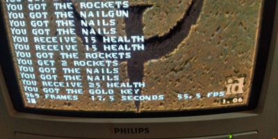

Like i said, the IGP is very fast, any PCI GPU i use is same or slower
At 400 you K6 is slight faster than mine in FPU, and slower than mine in ALU for what i see in your pictures. I see a big difference in Ram speed... 300mb/s vs 100mb/s i have, are you sure is correct?
I think you run quake at 320x200
123.42 KiB
197 views
and Doom shareware 1.9
34.82 KiB
197 views
I think this numbers are more or less the ones mwdmeyer check with a SIS vs Soltek board, that is 1.28 time slower
If i get 55.5 in sis in the soltek will be like 55x1.28 = 71.04
71.04 at 450mhz is 63fps at 400, more or less what do you get
But my Mendocino a 66mhz bus and 333mhz, i get 86fps in quake!!!! to have 86fps in a K6-2 even in a good board i will need something like 550mhz and 650mhz in a sis
This make sense in fusion, when i feel is like half speed my mendocino
