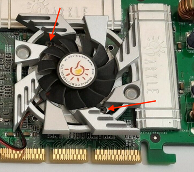

Reply 30 of 43, by Garrett W
I don't get what the issue is here. Have you encountered issues with ATi cards on this system?
In any case, the Noctua fan I was talking about is the NF-A4X10 or the NF-A4X20 if you've got some slight headroom. Make sure to grab the 5V, 3pin versions of either fan and you'll be good to go, no need to change the video card. Ziptie-ing it would actually be a good idea if you find that you can't mount it simply by screwing it in the old heatsink.

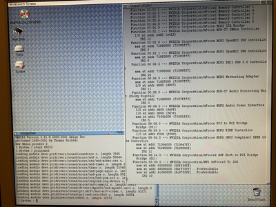

Interesting! https://forum.amiga.org/index.php?topic=27916 … 24328#msg324328
GF3 with Kernel 2.04 worked excellent...
Thx, I am currently hunting for the original fan or a suitable third party replacement.

The noctura fan will not fit in that case, it can not be placed inside that heatsink.

I did a google search for the fan last night but found nothing. The model # on the fan only returns a number of fans with full fan housings or 3 screw hole mounts but none with the 2 screw hole mounts. These were probably made special for the manufacturer of the cards.
The version I have is an EVGA GF3 Ti200 but besides the labeling on it, it appears to be a Sparkle card with the same cooler just doesnt have the Sparkle sticker on the fan or the Sparkle labeling on the memory heatsinks.
